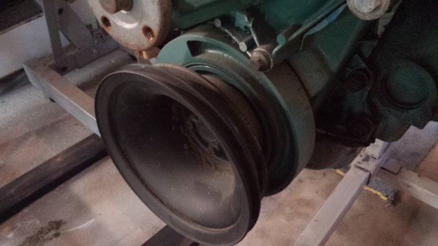

So I started scavenging the magnum accessories bracket and serpentine system from the 5.2 magnum I have to put on my 360. One thing that has crossed my mind while I was doing this is am I going to need to get a 5.9 magnum harmonic balancer to make this work? This 360 I have, I had the balancing move internally. This was 10 years go I built this 360 so I am unsure anymore if it is only the rear that was move internally or the front as well or if its even done that way?
The 360 balancer has a large weight on it, easy to tell from a internal balanced balancer
I didn't have much time to mess around with it today but I did do some measurements. On the 5.2 magnum and 360, from the block to the back of the balancer was 2.5625in. Now to the front of the balancer is a different story, the 360 is a 1/4 thicker to the front face. Does anyone have a 5.9 to measure the thickness of the balancer? Also can the 5.9 and 360 swap balancers to make this happen?

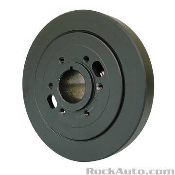

This is the 5.2L balancer

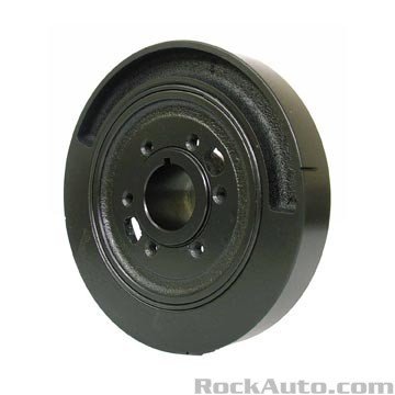

This the 5.9 balancer
You can see the area removed for the weight for the counter balance. A original balancer from the 70's looks a little different but you get the idea.
Here's one, you can see the difference in the weight.
Well sporty according to those pics, my 70's 360 block is running a 5.9 balancer. Now it is entirely possible I bought a new balancer when I built this engine years ago, because the pic you posted for the 360 balancer does look familiar but I have owned a couple 360's over the years so not sure. I do have all the reciepts for this engine so I am going to look to be sure if this is one I purchased. So if this is a 360 or 5.9 balancer there has to be different crank pulley whether it is a 5.2 or 5.9 because it doesn't make sense other wise.

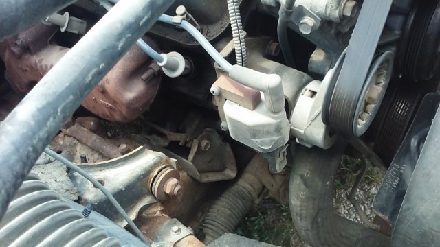

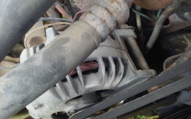

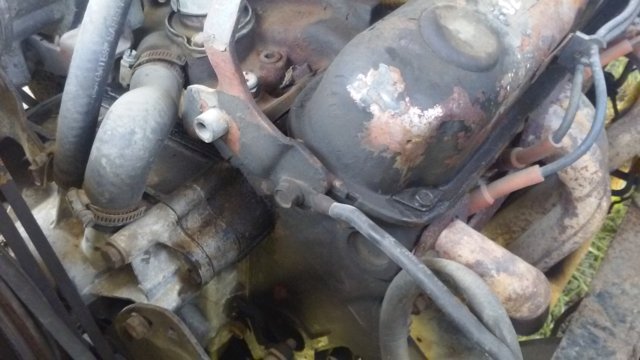

Took a look at both today. Problems will not be with the cover or anything associated. But mounting the power steering and belt tensioner will be the big obstacle.
They attach to the magnum cylinder heads. The LA engines do not have the head provisions needed.
I see the Magnums have more accessory bolt holes in the end of the heads, that's going to be a problem
