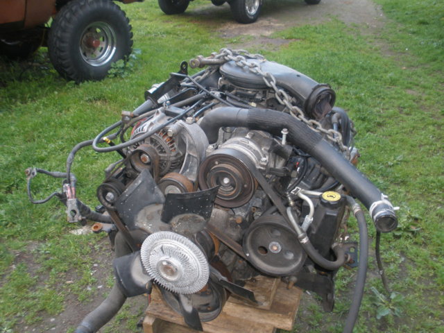

        power steering pump on zj is higher on right side.
      • 7mopar
        7moparWell-Known Member
        Messages:
        1,325
        Likes Received:
        393
        Joined:
        Dec 21, 2013
        Location:
        Kingsville, MO
        Its got to mate with the D350 steering gear. The 4500 lb. front axle reqiuires some larger line fitting. The right PS pump maybe the hardest part of this.
