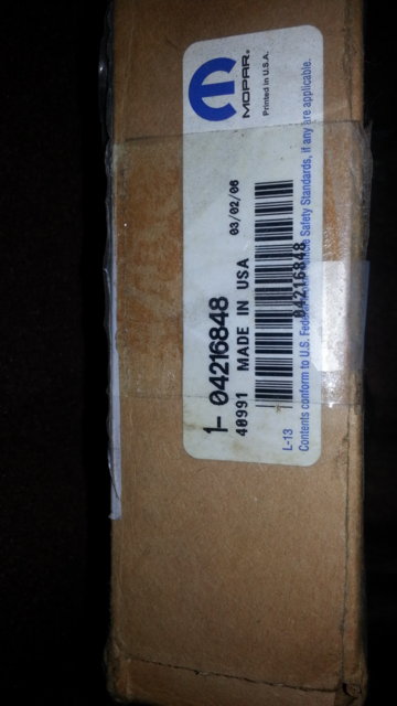

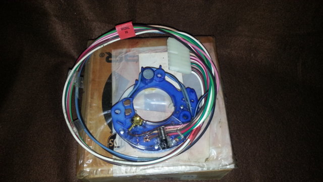

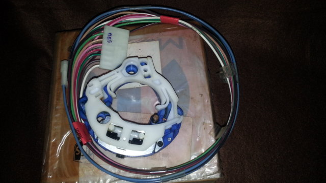

I have an NOS turn signal switch for Tilt and cruise for the 85-87 Ram trucks. It is part # 4216848 if anyone needs it. You can email me at kiwie49@gmail.com.

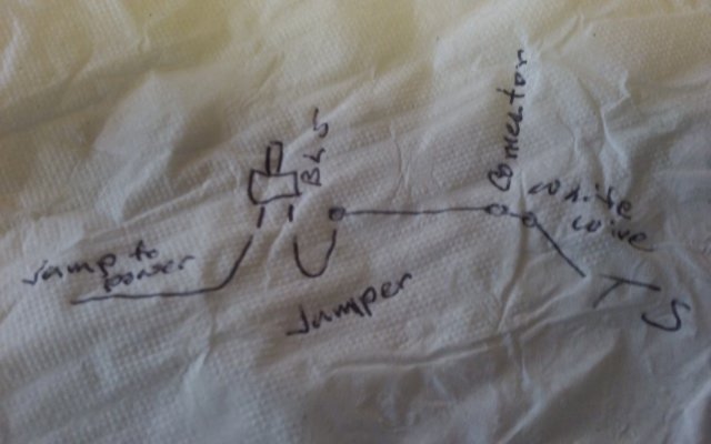

White wire goes to the turn signal swith. Jumper wire from one side of brake switch to the white wire. Power wil go to the other post on the brake switch. If all goes well there will be brake lights with pedal pressed.
