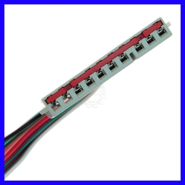

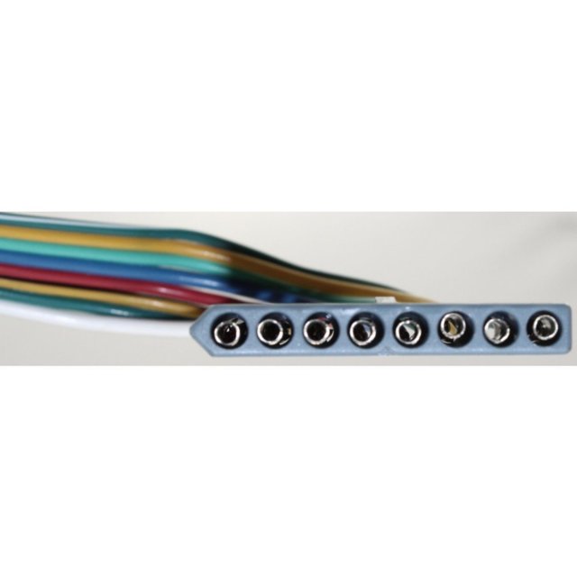

The problem in getting a new TS switch for these years with tilt wheel is impossible. Non tilt switches are everywhere. So your stuck with getting one for a 88 to 93 which has a different plug for the main harness and the cruise. I cut the old plugs off the bad switch and spliced them into the new one. I did them in order from the white wire on across
. I have done this before and had no problem. If anyone has the under dash wiring diagram, I could see what colors go to what function.
