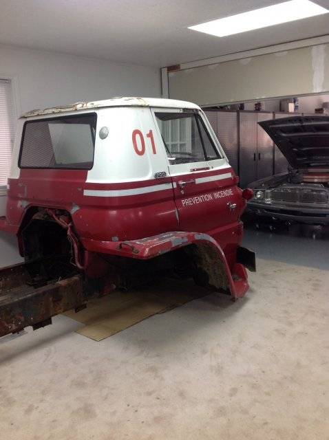

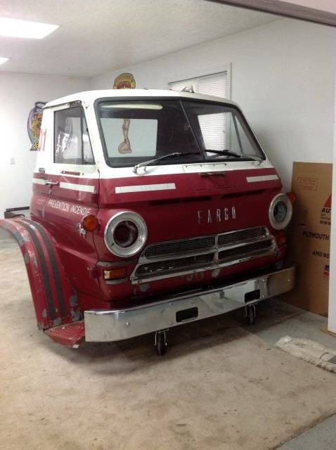

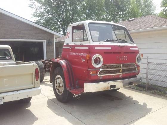

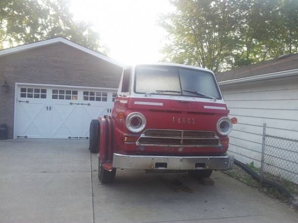

fargo L-700 at home
That's a cool truck, I'm looking forward to whatever the outcome is. (You should extend it and make it a Toter home since you plan on pulling a fifth wheel. That would help with weight!)
Thanks,well once i get the motor/ trans/rear end ill see what i will do, have to get everything i dont need out first and start to do some measuring.
Bruce

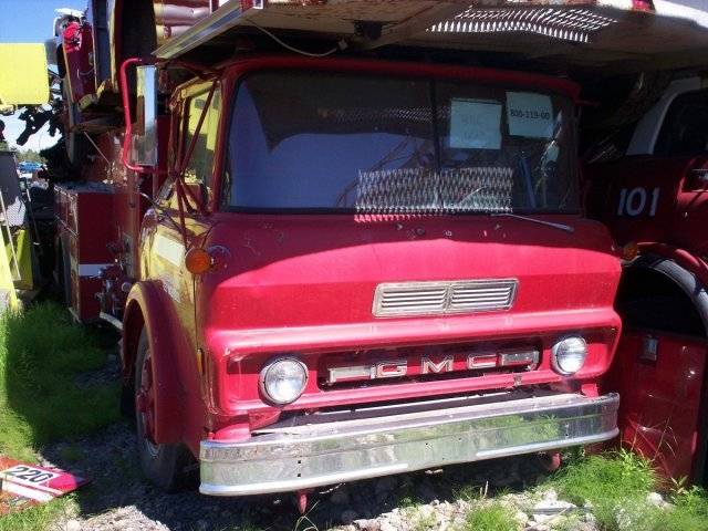

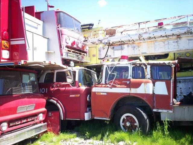

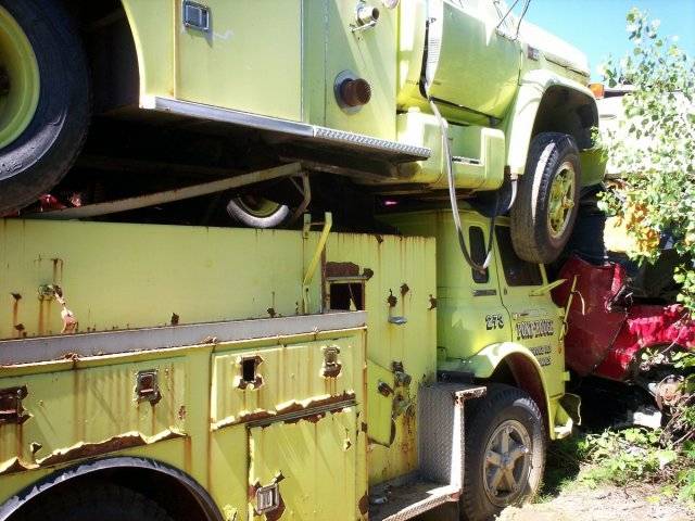

there is a place in quebec that has tons of old cab over's GMCs/INTERNATIONALS/FORD's all mostly fire trucks and in really good shape they just crush them for weight. i am Glad i saved the fargo from that fate!

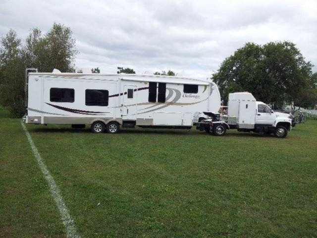

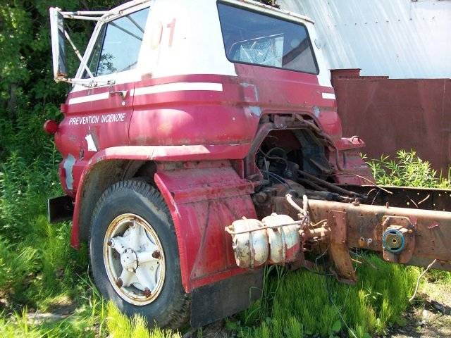

Hi Bruce, my cousin is trying to sell his fifthweel and TopKick that got a "Caterpillar" in it. Maybe you can find a whole TopKick and fit the Fargo cab on it?
Or maybe an old school or handycap bus (shorter WB) with a Cummins already in it.....
.........if I were two décades younger, that's what I've done with your Fargo..........Pierre

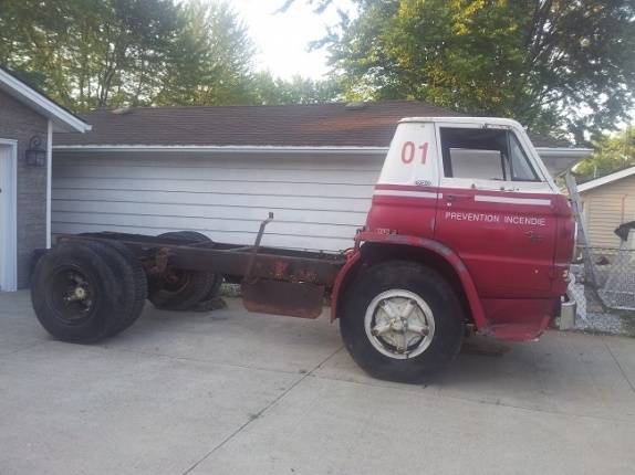

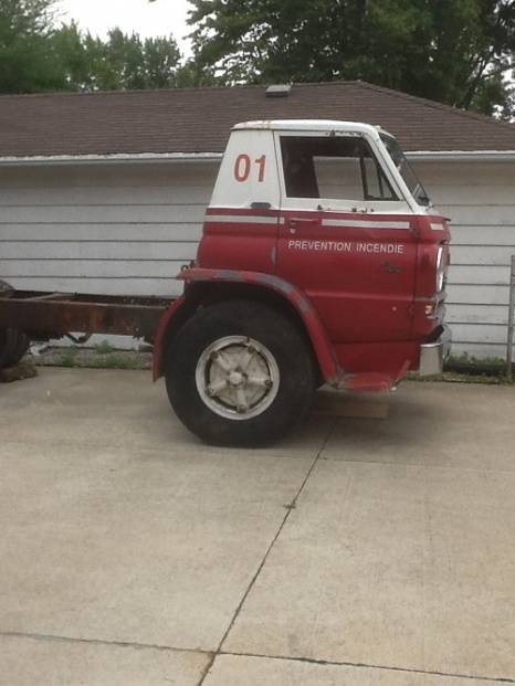

Here's the other five

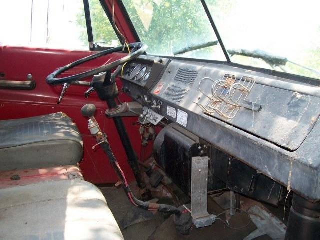

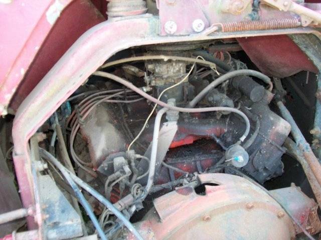

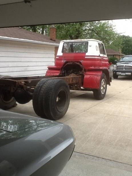

well i am going to shorten it 40 inches to make it to the smallest wheelbase they came in which was 89", remove the the old 361 and trans and rearend. remove the cab and take it apart for blasting and bodywork, i have a line on a 24 valve cummins and running gear. i was thinking i will run 4 super single tires on alcoa aluminum wheels. have the body painted and the trim re chromed and use it to pull a fifth wheel trailer. it's a pretty cool old rig should be fun to bring it back to life.most of the body is galvanized so is in great shape.
I am open to ideas the more the better. Bruce

It looks like the side glass is flat. If it is you could make a cardboard pattern and have any good glass shop make one out of laminated safety glass. many older vehicles came that way factory.
