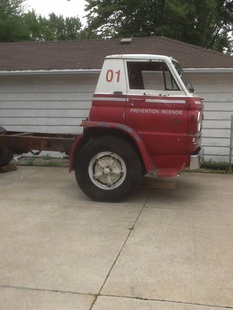

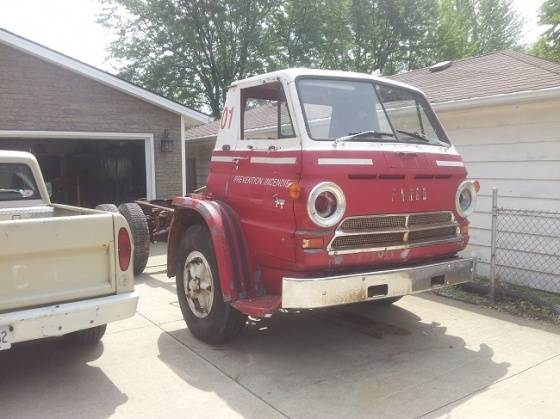

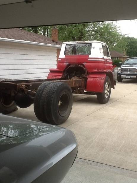

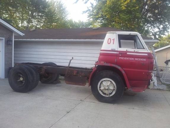

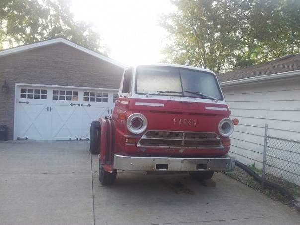

well got the fargo home, here is a couple pics.

I can think of a few things to do with it but what you going to do with it?
well i am going to shorten it 40 inches to make it to the smallest wheelbase they came in which was 89", remove the the old 361 and trans and rearend. remove the cab and take it apart for blasting and bodywork, i have a line on a 24 valve cummins and running gear. i was thinking i will run 4 super single tires on alcoa aluminum wheels. have the body painted and the trim re chromed and use it to pull a fifth wheel trailer. it's a pretty cool old rig should be fun to bring it back to life.most of the body is galvanized so is in great shape.
I am open to ideas the more the better. Bruce
