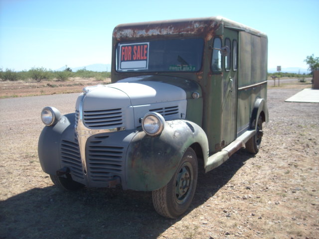

    I could not find a modern rim with the same bolt pattern when I was trying to replace the split rim wheels on a 1947 Herman bodied Dodge delivery van (see pic) last year. Alcoa would special drill a set of their aluminum wheels but time involved and money were factors. They also wanted a certified weight slip to make sure the wheels would not be overloaded. If 16" ended up overloaded in their opinion they wanted to substitute 19.5" but would still drill lugs to match. I ended up finding a Diesel truck (18 wheeler big rig type) tire shop and they were happy to do it but I paid $60 ea. for mount and balance when the normal charge was $30 at their shop.
