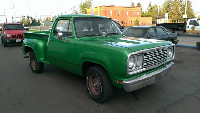

So I have this pet project in mind that I'm entertaining for later on down the road. It's inspired by a late 70s D100 my Gramps had back in the day, that I had some nostalgic memories of (namely remember the grill). This is more of a passion project that I'd imagine goes against "what everybody else does", so here's what I got in mind:
-Mid-to-late 70s D100, either stepside or shortbed panel w/ small lift (they both look good so it's hard to pick)
-225 Slant 6
-Aftermarket EFI
-Turbo setup with mild boost (mild enough to keep stock engine internals)
-Either 518/46RH or a500 trans (see below)
-833 geared somewhere between 3.55 or 4.10
Since I have a half hour commute going anywhere, a small engine and a decent cruising trans are vital to making it cost-effective in the long run (the turbo makes it peppy and worthwhile). I'd like the capability to tow a car on occasion, so that's where I figure on beefier springs, bigger (power) brakes and a trans oil cooler. The turbo adds to fuel economy when I'm cruising (excess of teens mpg would be nice), and beef up power when I'm towing or just laying on the gas. I know that the "bigger engine" crowd will chime in at some point, but tbh if a naturally aspirated slant came stock in a D100 then a slant with a turbo and overdrive trans will do just fine (Ford's doing the same thing with the ecoboost in their F150). Sure I could probably save on the work and just get a newer pickup that could do all these things, but the passion just wouldn't be there (plus I'm seeing long-term reliability with cars and trucks go down as they become more and more reliant on electronics, the basic EFI is the most I feel comfortable relying on them).
