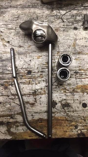

Well I found out what was wrong, motor was running on 7 cylinders, check the picture out will explain everything. Still changing the manifold out to the dual plane.
Maaaan ! Yup ! That's an issue all right ! The motor must have been running rough . You couldn't feel or hear that there's was something wrong ? Luckily , It look's like a clean brake but I'd still look for any debris while you have the engine apart . I hate to say it but I did something like that one time with a 440 six pack . During a race with a big block Chevelle . I bent one push rod like a banana and the other one went right threw the rocker arm . The car still got me home though . :D
Took a good look drained oil and filter and ran a magnet around to pick any loose steel up, runs like a champ again, and surprisingly it didn't feel like it was running rough just felt like a cam.
Thanks a lot for the help though, it's running like a champ now, I'll let you guys know how it is after I change the heads and intake. Thinking that will bring me up to just over 425 horse to the motor
Glad to hear there was no metal and no other damage ! You got lucky ! :D I really am surprised though that you didn't feel or hear that one cylinder down . If you think it's running this good now , just wait till you get that other intake on . I bet your going to be pleasantly surprised ! :cool:
