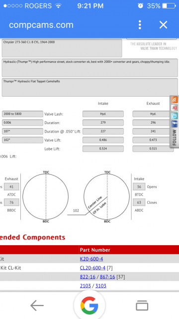

Here's the cam sheet give me any pointers
The 107° lobe separation does nothing for bottom end power. Your truck weighs approx 3800 lbs.
With out a cam change to something closer to 110° separation you will have a lot of tunning, trial and error to get thing right. The more weight lost the better.
