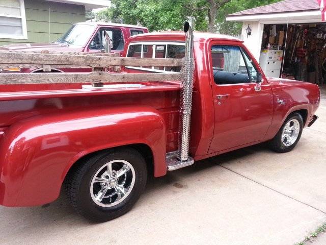

Its been a while since I poked my head in here. Figured I would give an update on the truck.
For those that dont know- its a '78 Warlock with a 5.7 VVT Hemi and Viper 6 speed swap.
Rebuilt the suspension and lowered it this spring. Also added nitrous to it and had it dyno tuned so it wouldnt blow up. NA dyno'd same as last year, but with nitrous the numbers jumped quite a bit. 600hp at crank, 520hp at the wheels. Torque went crazy- 675 lb/ft at crank, 590 lb/ft at the wheels.
I also added CalTracs in an effort to bring my 60 times down. They cured my horrendous wheel hop, but I wasnt able to play with them much before the truck suffered major breakage. Clutch was completely shot trying to hold power it wasnt meant to handle, and I sheared the splines clean off one of the axles. Best time at the track was 12.4@114 with a 2+ sec 60 ft. If I can ever get the suspension to respond, it should be well into the 11 sec range.

I just asked you this in your garage post but then I just found this thread , so I figured I'd just ask you here . With the CalTrac's , Did you go for the system or did you keep your stock springs and shocks ? Maybe you could include some pictures if you have them of the set up .
I just went with the traction bars for now. I want to set the GoPro up to catch the suspension action so I can see if there is a need to upgrade the shocks and springs. They definitely cured the wheelhop, but I wasnt able to get wheelspin under control before I snapped an axle. Just got the clutch and axle repaired in time to watch the snow fly so I think any testing will have to wait for spring.

My exhaust is fairly quiet at idle and cruise, so it does surprise people when they see it running 114 in the quarter. The motor is still 100% stock , so that throws people as well.
The problem with my exhaust is that its under the rockers right where I imagine the frame outriggers would need to be to connect the cage to the frame. It might work out though, I am planning on swapping the saddle tank out for a rear mounted tank. That would open up some space inside the frame for the mufflers. Just have to get creative on how to get it out to the stacks.
