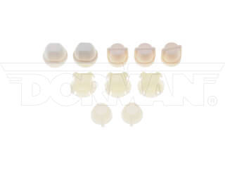

I'm looking at the Dorman box right now & the part # reads 118-301 wiper linkage bushings. There are 2 different bushings on these. 1 is for the linkage itself & the other is for the motor to linkage arm. (Arm from motor, bolts to motor that goes to linkage rod) I have both, but forget what ones were in this box. 1 bushing is open all the way through & the other is solid on one end.

The part I listed has them all. No guessing. I've used them before, needed a few of each which was perfect. Better than trying to figure out each size needed. Whopping $10. shipped.

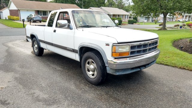

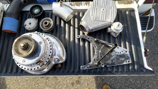

Thanks but its not a V8, yet. Ive owned well over a dozen Daks and love them. This one is a 3.9 5spd thats currently my work truck. She sees about 1k miles a week. I did just land another one that Im doing a trans in. After that the lil reg cab V6 will get a Paxton blower Ive had laying around just for shits and grins. Oonce I waste the 3.9 with overboost ;-) I have a mild built 5.2 that Ill drop in. After I waste the 5sd with either engine I'll swap to a built A500. Few pics..

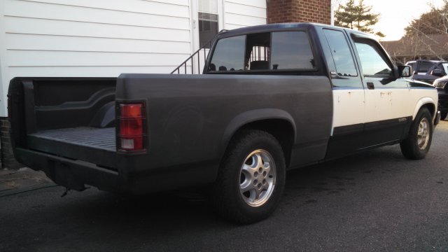

New one getting a trans..
Little bit of fun..

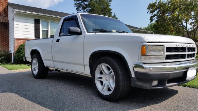

This one was a very modded 3.9, 5 lug convert with 8 3/4-4.10 with 150 shot N2O. That was my profile pic over on dodgedakota.net. I was Fazdak.

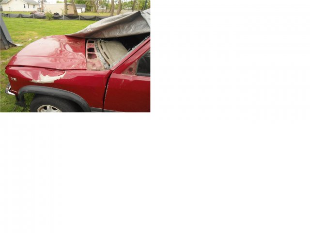

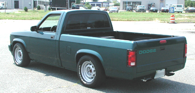

What body style 8/34 rear did you use for the 5 lug conversion? I would like to do this to mine some day, but the less cutting I have to do to the rear the better, Or is there an 8 3/4 that fits pretty close width wise (A Body?) Not too many wheel options for a 6 lug set up. Man Dakota's up here are difficult to find in that shape. Your lucky to live where you do. I do have a picture of a Dakota I got for $200. V8 & 3:91 sure grip rear, bone stock. It WAS a nice truck until an 80' oak fell on it. Thankfully is was parked on the guy's lot with no one in it.

Mines an E body. Like 1/2" wider wms to wms. People always told me A bodies were the ticket but I had an E body laying around and liked it considering Dodge always uses narrower rears, E body is damn near the exact track width of the stock front. I welded new perches in the right places and used Comp Engineering lower coilover mounts for shock mounts, just in case I even went coilovers they would already be there. Those are my 73 Challenger rally wheels on it the green one. Man that Dak is FUBR! Damn shame. My 340 Chally, been in storage for going on 21 years now..
