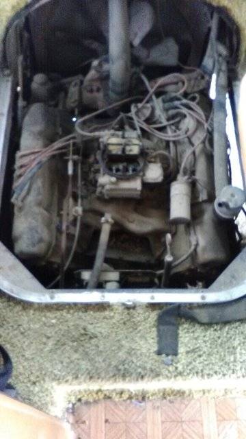

Donor motorhome .. Fired up today, don't sound too bad ...
Real good possibility the tourqe converter is studded to the crankshaft.
You cutting the front off or dropping it out the bottom?
Yep. Industrial 413. that motor was built to last my friend! Take care of it, it will see your grand kids GREAT service! Thats an RB block make that a B block and you have what my 383 looks like!

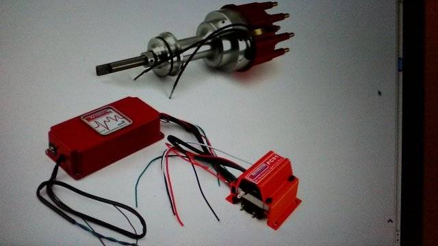

have a concern !? truck currently has da 318.. my son drives it to school for now till we get all da parts needed to drop da BB, BUT its not running right !? it starts fine but when ur driving down da road either slow or high speeds it looses power to a scritchin hault !? was wondering nd heard about da LEAN BURN !? could that be da problem !? changed da rotor cap, timing chain, fuel pump, distributor, spark plugs, rebuild carb,.. nd it still doing it .. help someone !? ..
Was wondering if I just install this set up from proComp Nd get away with lean burn, .. Has any one don't this !?
Does it still have the factory ignition box on the firewall or on the inner fender well? -Those damn things were known for that!
