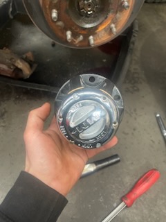

HI Guys, Im looking to install a mile marker transfer case conversion kit, should be going in over thext couple days. I got a set of front locking hubs with the kit, just wondering if there are any additional/alternative pieces I will need to adapt the locking hubs to the front axle? I know the late 70's trucks had the AWD transfer case, so no locking hubs. Is there maybe a conversion from a later year truck after they went back to part-time 4WD?
Any help much appreciated!

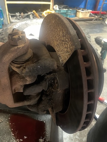

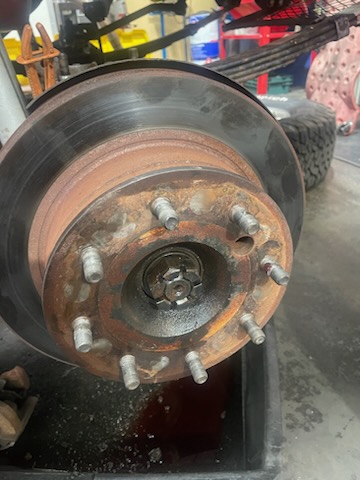

Just an update here for anyone else looking to do the same conversion.
The 75-79 fulltime D44 axle will need the following parts swapped to complete the Part time 4x4 conversion,
- Front knuckles
- Spindles
- Wheel hubs
- Outer stub shafts
these can be taken from an 80-93 D44 axle, straight bolt on. They are also able to be swapped in from a Ford or Chevy from the same era, even the in-house 10-bolt jobs.
These later models (part time 4x4) have the wheel hubs that stick out through the wheel, where the locking hubs will attach. the fulltime hubs do not, and therefore, must be swapped out. I have been on the hunt for these parts from several wreckers, and there is some availability out there, only problem being that Im on the other side of the world, and most yards want to move entire axles rather than wrench totake them apart. Maybe not a bad option for you guys stateside, but I suppose Ill have to keep scrounging to find the parts I need.
Hope this helps.
