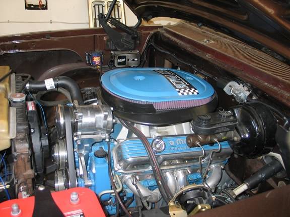

will a 6 pack setup with factor air cleaner fit under the hood on an 81 truck?
You should have a ton of room under there . I'm thinking of going with a duel quad next year under the hood of my 79 .
Np. This is a friend of mines 440 six pack in an 80 Ramcharger.

Wow , What a "clean" install Indy ! I'd love to see more of that one . May I ask , what headers is he using and how do they fit ? The headers that came with my Warlock have clearance issues around some of the plugs and I'll be shopping for another set this winter . By the way , how's your killer step side coming ?

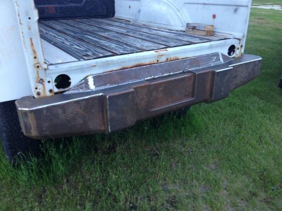

Wow ! Between the rear bumper and the front one you have your going to get them both coming "and" going ! lol I'd appreciate any input on the headers . I've got mine so they "just" clear the plugs but there still to close to the plugs for my comfort and it's been a while since I've done a big block truck and I can't remember weather I used hooker or headman on my last one . I also apologize to "68GTX" . It's just that I'm into all things Mopar and my question might not only help myself but someone else and "secret indy" knows how to build some NICE trucks . I wouldn't mind seeing how "your" truck is coming along either . Pictures , hint , hint . lol
Talked to him today and he said his headers are TTI. Hope this helps you out.

its not looking like its gonna fit on my smallblock, air filter housing doesn't clear wiper motor, I have a diff wiper motor on my parts truck, which orients the motor the same way as the one in the picture, but it still doesn't clear. I think on the smallblock the engine is set back further..but the wiper motor in the picture does look smaller around in the electric motor end than mine. any ideas what he used for a wiper motor???
To me , It look's like a stock early 80"s wiper motor . It look's like the same one that's in my 84 and "should" be the same one that's in your 81 .
Sorry been outta town for a few days for work. I'll see what I can find out for you. He's a busy guy so might take a day or two to track him down.
Sorry for the delay. He can't remember exactly what year it is but it's from between an 87-91 ram. He talked to Bouchillon Performance and that was their recommendation. Hope this helps.
