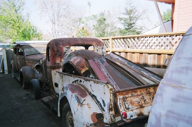

yes , 59- 60 share the same cab , i share the same issues . found a 60 in a bone yard near napa/vallejo area . he right there on the coast inland bay . mine got rust issues also . but i'm modifiing mine so replace or reconfigering is part of the process .

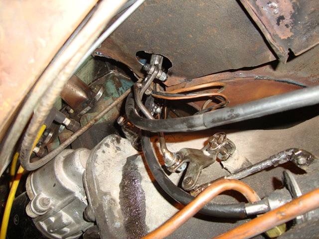

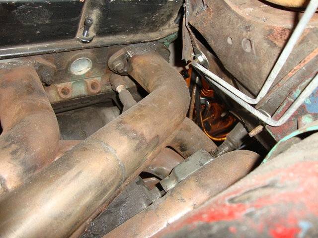

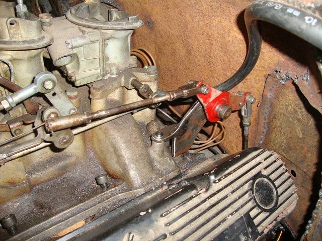

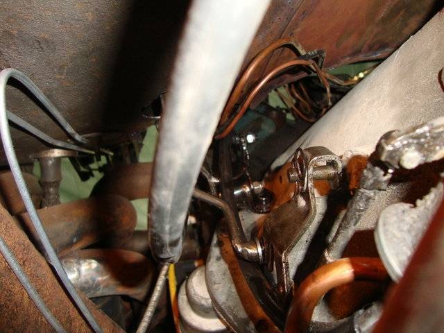

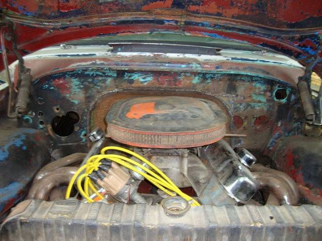

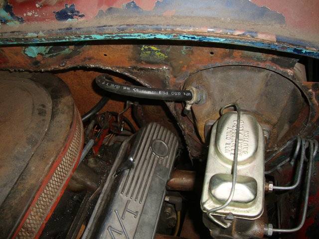

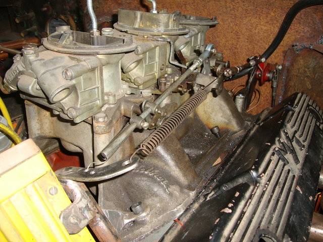

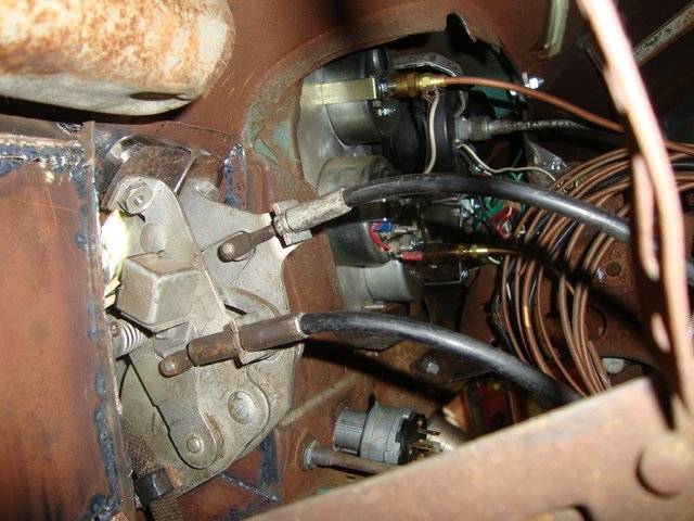

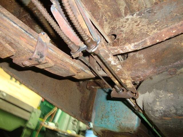

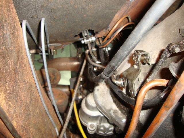

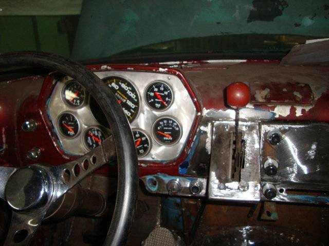

no its still there . i'm repairing mine . my firewall and dash and floor are modified so . i'll leave the good ones for resto's . my phank n dodge is a hotrod . modification is state of repair , lol .
Wow, MAJOR mods. good idea on the dual master cylinder with booster. V-8, etc Big project you have. keep me posted.

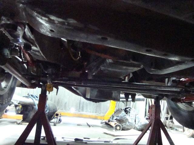

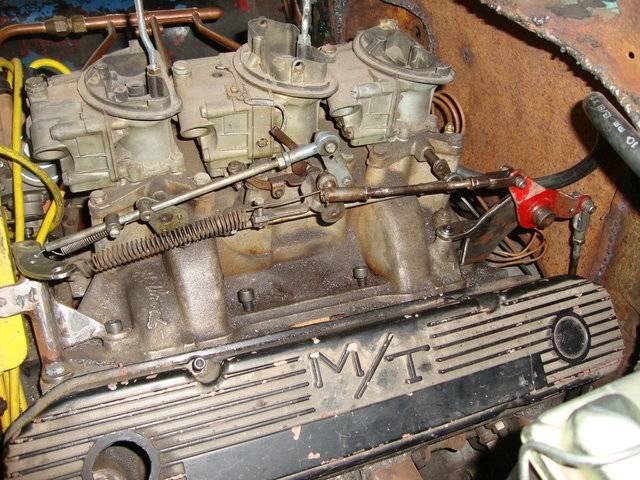

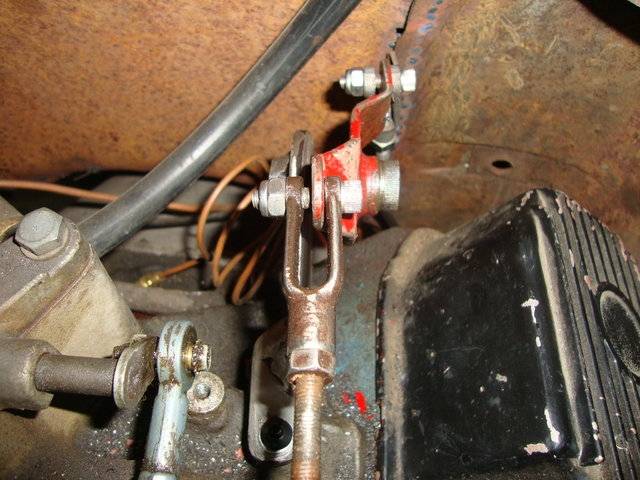

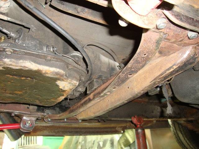

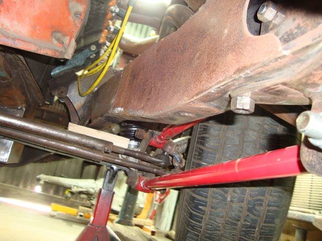

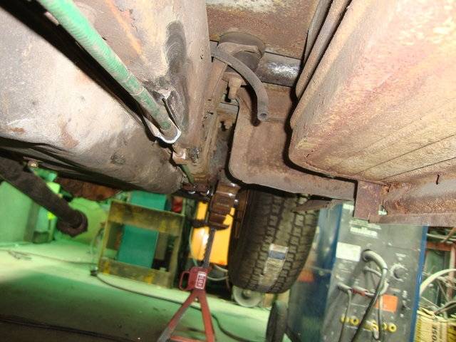

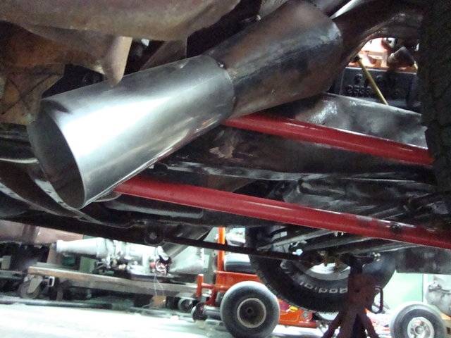

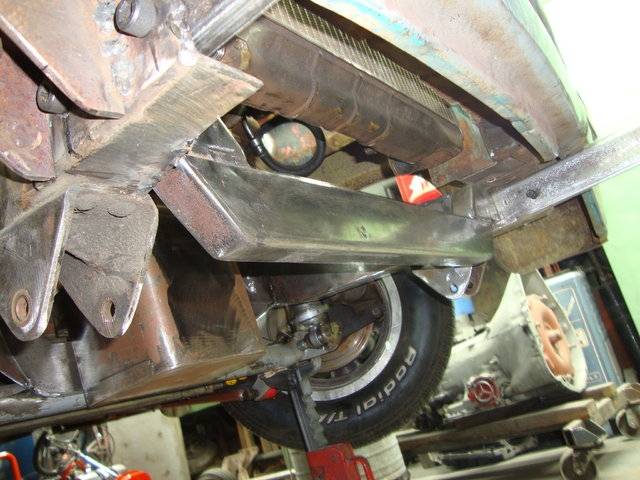

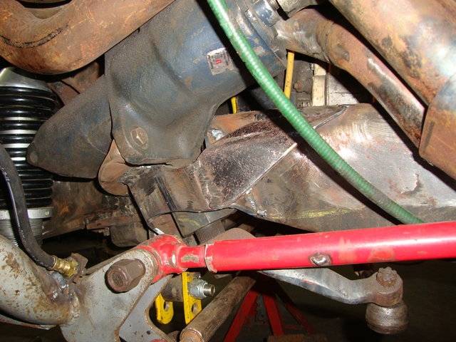

Wow, give me some notes on the photos. you have IFS up front, what model? and engine, got more details on all what you are doing?

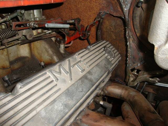

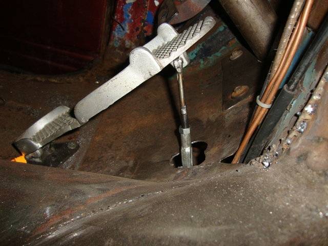

no ifs here , old tube dropped axle with coil overs and four bar and a panhard bar , used a mopar pw steering box and put cross steer on it . put e brakes to the r/e , as the dash shows its an auto , did some rocker covers set back on the firewall as well . did a 1/2 fuel line for the big inch rb wedge .

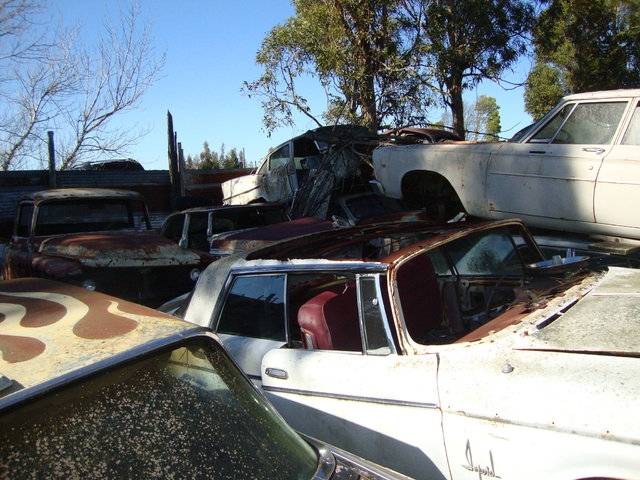

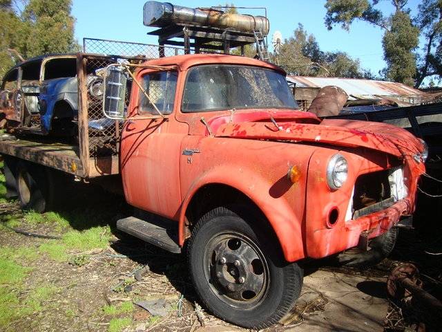

I talked with Brian today. he said he has a decent cab. not sure if it is 58 or 59; some confusion there, but now, I need to get some pictures to verify what it is and what condition it is in. As you know, he does not do photos or internet. Need someone nearby to check it out, - I can't get there easily, 500 miles. Do you have any closer photos of the red one?
this one ? that other one in the back is a 59 . but brian don't see everything sometimes . i can't say when i'd be gone that way . but i could shot more next trip for you .
OK Thanks Paul. I was wondering about the red one, he wasn't sure about the year, but I see it is a 58. Has the running boards outside the cab, 59/60 had them inside the doors. He told me the red one was in good shape. looks to be, but wrong year.
Apparently, the one in the back (as you said, is a 59) has a lot of rust outs, in same places as my cab. probably no go on that one.
