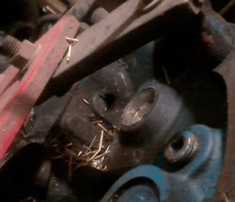

    I never came back to do an update on this... I did pull the tranny and lo-and-behold the freeze-plug (in center of pic) had a small nick in it and was leaking into the hole right below it (had a pic but can't seem to locate it).
