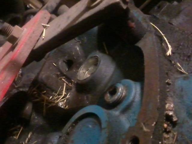

This is what I found and was not expecting but it has been awhile since looking at the back side. This is a 78 block, picture is not real good but think you will get a idea of what needs to be done. 360 block 001.jpg
So does this mean there's a top hole for that cavity? If so, then I could plug the bottom one and fill from this one perhaps?
Picture is of back side of block looking down. The hole goes clear throw the casting and has no bottom. My guess after looking at my block would be the freeze plug above the hole is leaking and no amount of epoxy put in the hole will repair the leak. If you do not have the body on removing the transmission would be the best way to verify if the freeze plug is indeed leaking.
If you look at my photos, the hole I'm getting the coolant leaking out of is at the bottom of the block, drivers side just above the starter.
It looks like you've got the block on a stand, you should be able to spin it around and see the one I'm referring to.
The picture posted is of the top side of that same hole location and is just below the freeze plug suspected to be leaking on the back side of the block. On my 78 block the hole is open all the way through the casting.
Okay, so it could be a freeze plug is leaking into that top hole, and coming out the bottom one? That's a much more encouraging scenario!
