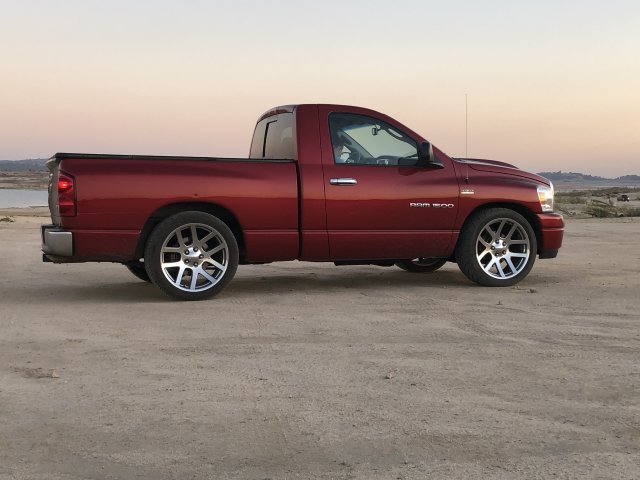

I've been the original owner of this truck since just before Thanksgiving 2007:
It is an SLT model in the short bed, regular cab configuration. It has the 5.7, the 545 trans and 3.92 gears in the original 9 1/4" axle.
It has been a great truck and I intend to keep it.

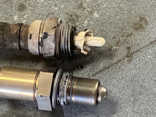

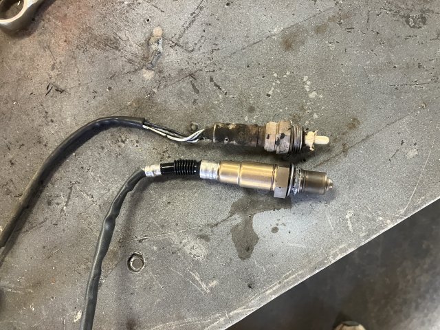

The upstream O2 sensors looked pretty crappy. Here is the LEFT side next to a new one.
Closer.....
Note how the "barrel" at the end was blown apart and mushroomed. The white discoloration is strange too.

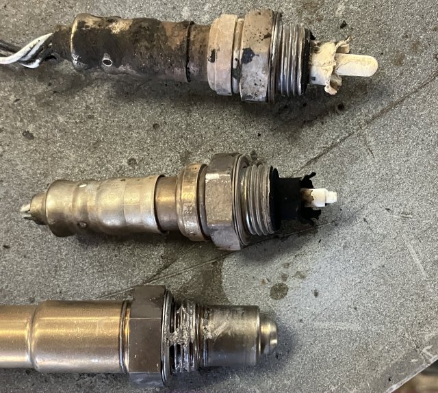

Now the right side:
Same condition of the "barrel" but the housing is sooty black, indicating a rich mixture going through.
Finally. original LEFT, RIGHT then a new one for comparison.

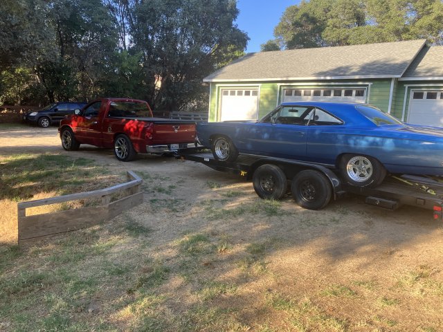

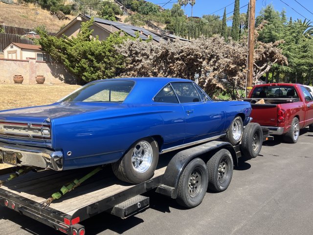

I went on a 300+ mile drive today towing an empty trailer one way and with a 68 Plymouth Satellite coming back.
NO codes. It ran great!
The car is a 1968 Sport Satellite. It belongs to a friend that needed my help with a few things on it.
Nice car, very clean and it performs nice.
