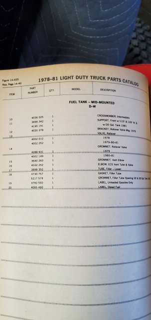

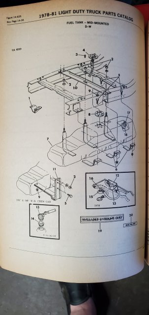

Dec 1, 2019
21
4
illinois
dan brooks and vd here are 3 pics from factory parts book 78-81. the pics are of the gas tanks,mounting and such. vd, 80 had 2 tanks only, 1 for us and 1 for cali. dan yours had 2, a 20 gal and 30 gal. later tanks had circle on bottom and a number in circle was the gallon size of the tank. i.e. 15,20,22,30,35,36 etc. this should provide all the needed info.
