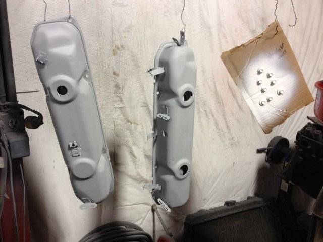

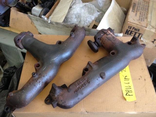

Had this one for sale about a month. Interest, but none serious. Spent the day refinishing 440 parts. One manifold in good shape. The other is rough and has a crack.

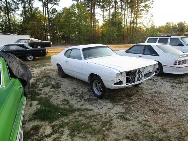

Went balls deep in my Demon project, this one is for sale. Out of the country for awhile so this one is going to sit. I am not giving it away, but the reserve is low. I put a completely gone through 8 1/4 with 3:23 gears in to replace the tiny Dana this truck came with.
A lot I was going to do with this truck.....

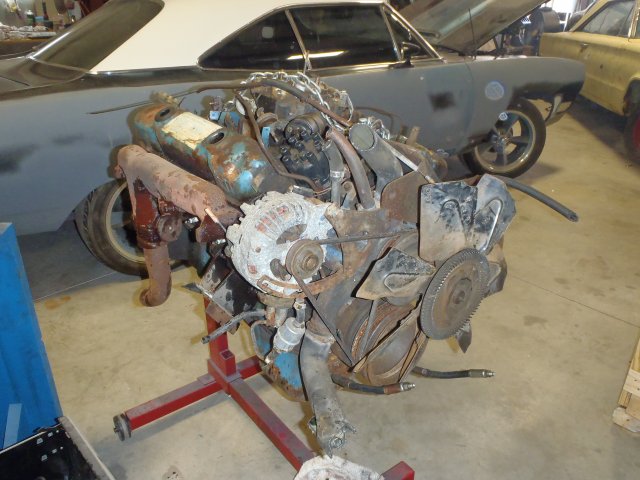

The motor I built for this truck was a virgin bore and required no bore work. I put big valves in the heads a nice cam and completely rebuilt it top to bottom and will run here in short order and put up for sale. Very nice stock motor with some upgrades.

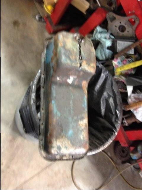

Ok guys been in contact with the new owner of the truck. He was daily driving it since he bought it with no issues until the motor let go. He wants to swap to 383/727 with floor shifter. What's he need?
Engine with truck pan, trans with lines, radiator, truck motor mounts for engine, exhaust and what ever he wants to use for a shifter.
If he pulls a complete engine and trans from a car.
Truck engine mounts, pan, oil pickup tube, radiator may work out of car and what ever shifter.
Ok...this truck was a slant. Can he just use the schumaker slant to BB mounts. I got him the correct pan, pick up, etc
