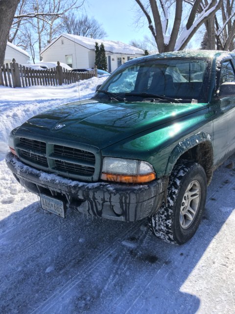

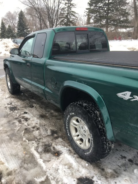

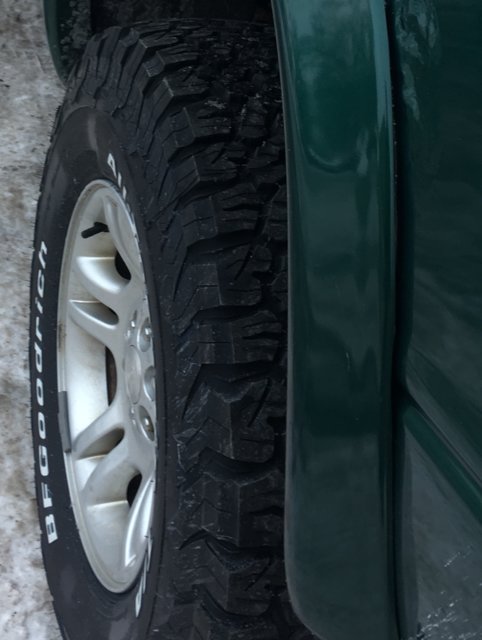

    Settled on an 03 4wd with3.9. Bald tires and a bad ball joint.
    Cheap enough with the standard MN rust. Not too bad for the 150k + miles. 2 inch receiver and tonneau cover. New BFG /AT tires, ball joint and align and it’s feeling like it’ll do me for a while.

      That shouldn't be too bad, just mind that it's a V6 when planning on towing.
      As far as the ball joint, I recall the Dakotas and Durangos of that generation sharing parts like that, if so then swapping the ball joint yourself shouldn't be too bad. I did mine on our Durango, you can get em pre-pressed pretty cheap. Just note that if they're still the factory ones, you'll have to grind em off cause they're riveted in
      P.S. If you follow this guy's example but don't get the Moog joints, don't bottom out the zerk when screwing it in. I got ACDelco's, they're already tapped and only meant to twist in partway.
