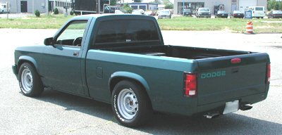

Zactly! Matter of fact I had a 94 3.9 Dak that was wicked. With 120 shot I walked Camaros and Mustangs regularly. Ported V8 TB, worked beer barrel intake, mild port heads, 1.7 RR's, 3200 stall converter w/ shift kit, 70 8 3/4 with 4.10 l/s, weight removed and the mentioned n2o. Was one of the most rewarding things I've played with in all my years of tuning. Only pic I have left of it, damn laptop crashed and lost em all.

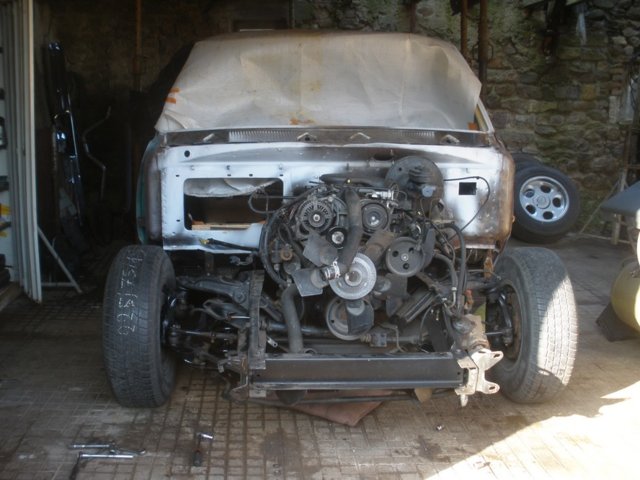

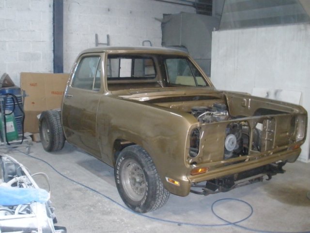

Did a 94 zj magnum swap in my 72 D100 got the exhaust manifolds from a 5.9 DURANGO custom y pipe and exhaust PLAN IS TO KEEP THE OBD1 and the efi running. will have to modify the side tank for an internal fuel pump.

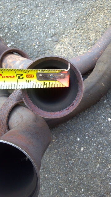

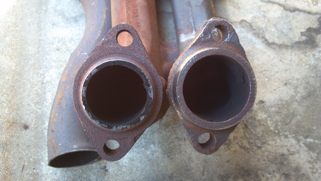

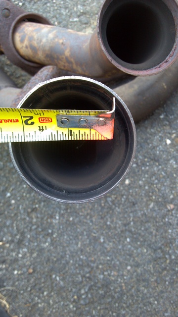

They're still 2.5 collectors. Even though its the biggest Mag they made, still used off the shelf parts from the 94+ 5.2's. Get yourself some 92 or 93 manifolds from any Dodge 5.2 or 5.9, you'll see what I'm talking about. Cool swap, do you have a thread?
One on the right is a 93 Dodge B100 5.2 and the left is a 96 Ram 2500 5.9.
Corresponding Y pipes

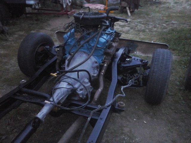

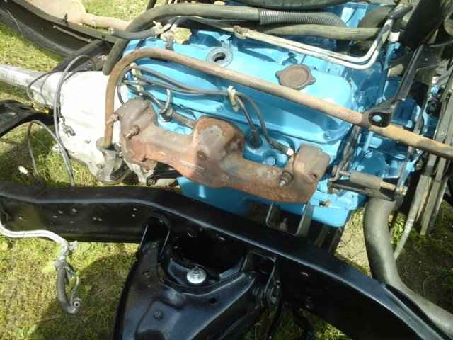

Tried the magnum manifold on the LA engine they fit nice custom y pipe was fabricated . 92/94 dodge manifold are very rare in my country. its more easy to get a used zj for parts at affordable price.

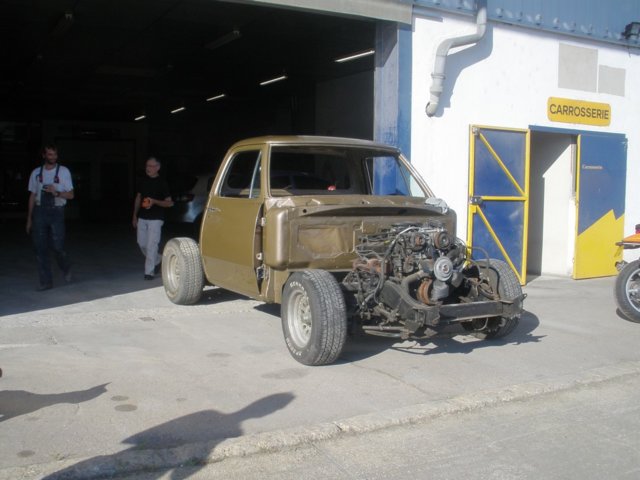

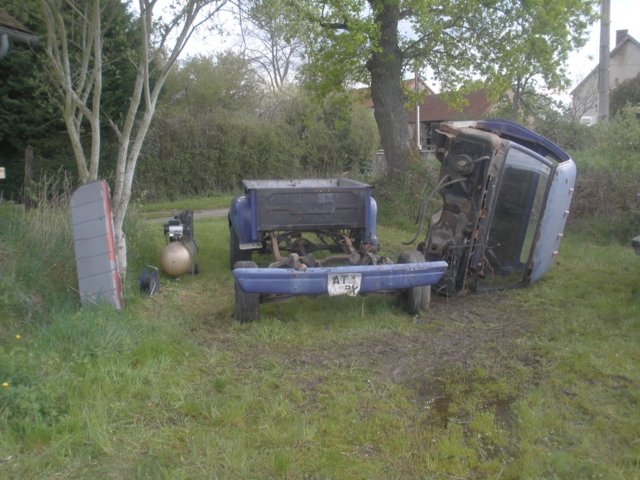

first the mag engine was on a ramcharger 2wd frame for a test fit. The ram body was junk then a 76 cab w200 was bolted on, bed was shortened to complete the ultra short truck with 106 " wheelbase .

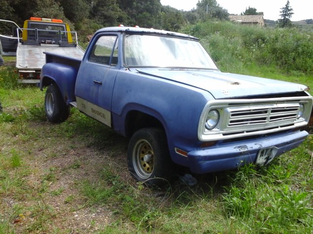

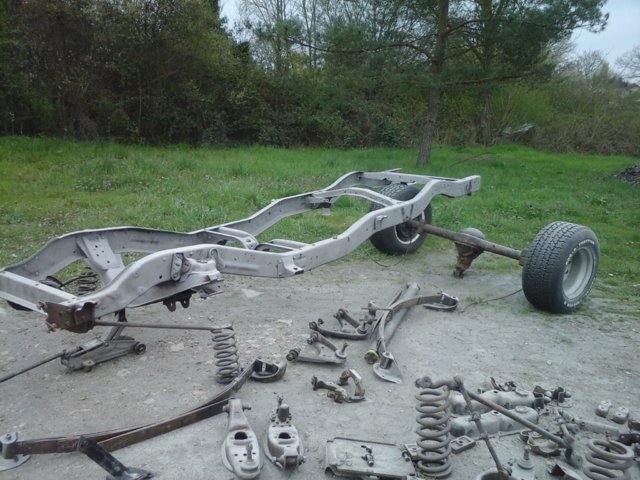

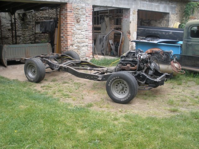

Later in the year, friend on mine gave me a phone call sourced a 72 d100 shortbed utiline for parts. bought the truck, get rid of the rotted body, had the frame sand blasted and epoxied and started rebuilding the truck.

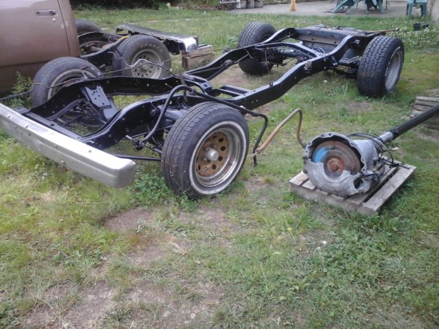

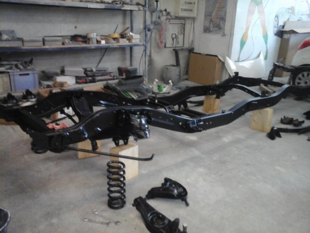

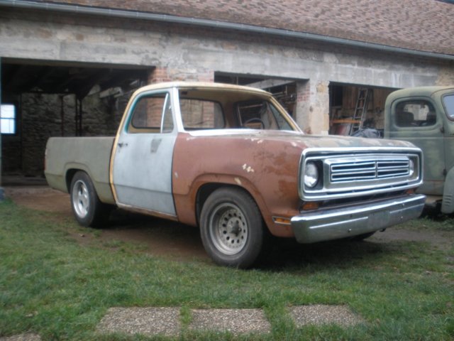

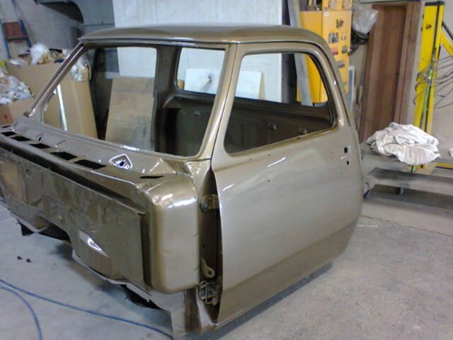

to keep her street-legal the truck will be be buildt close to FACTORY STANDARD despite dakota spindles and flipped rear axle. sourced a A500 as well as a90 tbi from a 90 van and plan to add the overdrived tranny with lock up. engine had an overhaul from the previous owner new bearings new rings, timing chain, oil pump, and a brand new throttle body and another ecm for spare. while this time body was in the shop for prep and a paint job.

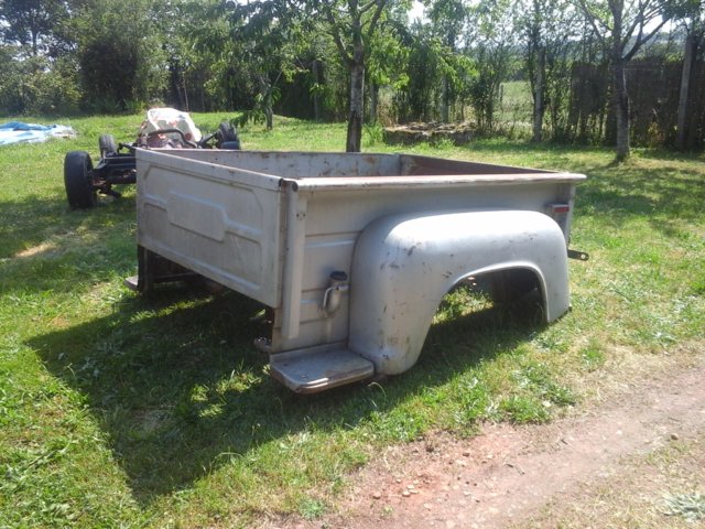

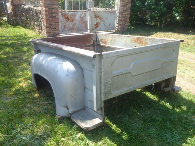

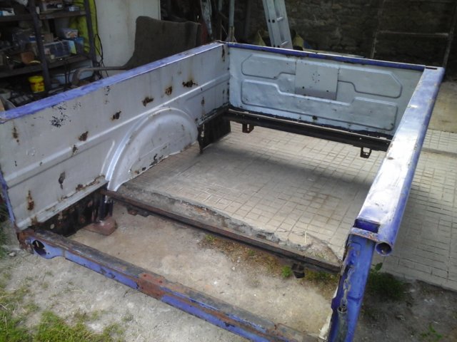

The stepside fenders and one side of the bed were rotted as hell so started hunting a new descent one and find someone who is willing to help for shipping remember that i live in FRANCE one ocean away. Finally found one in california at reasonnable price( thanks again to the seller)... 6more months to wait before getting the bed home.......
