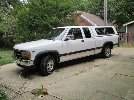

don3.jpgGetting ready to drop an old school 318 4 barrel in my 92, Ive been pondering the same question, My v6 pump come from advance 6 years ago. cant say I have any complaints about it. my valves are worn out, the tranny is bad, but it cranks first bump of the key, every time so there is no fuel problems, no problems going down the road either, So Ill probably go back to advance, although I do use napa all the time as well.
