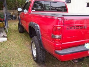

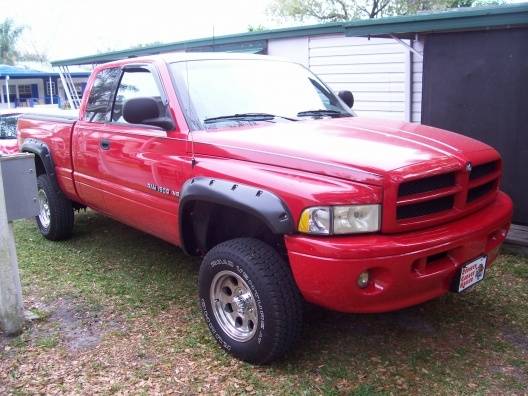

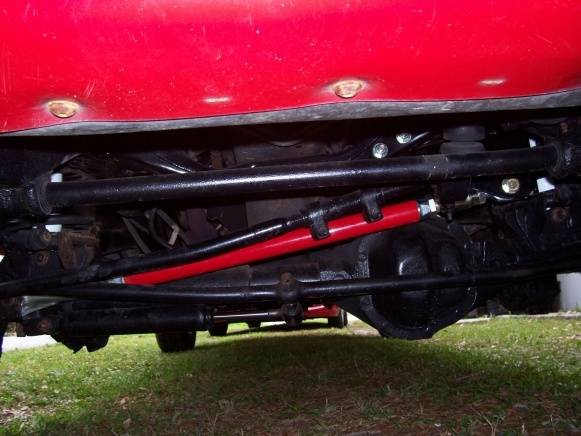

102_2755.jpg102_2753.jpg102_2754.jpgI own a 2001 ram 1500 4x4 quad cab i bought a rough country 2 1/2 lift with shocks [http://roughcountry.com/dodge-leveling-lift-kit_374.php] ,i also replaced the track bar with an aftermarket adjustable track bar [http://www.dtprofab.com/TRAC-BARS-STEERING_c_26.html] i highly recomend replacing the stocker with an adjustable this one was in my budget but dodge off road has one thats favored by many. I'm able to clear 33" tires no problem,rough country offers 3" and 5" lifts [considered a 3-5 lift] but at my age i ain't into climbing up to get in my truck [with the small lift i can tell the difference] have not gotten my tires yet but that's next.

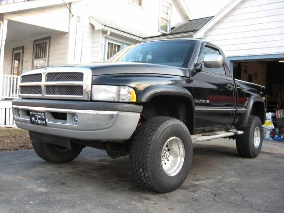

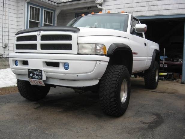

Personally I really don't care much for Rough Country after I used there lift on my 84 but they probably would be the cheapest way to go . Here is my old 95 with a 3" SkyJacker lift and I ran 33's without a problem and it rode better then with the factory suspension . Now I have my 97 with a 5" SkyJacker and I run 35's with no issue's . Hope this helps .
There are many choices out there I procrastinated for months before I chose the rough country, Bear is quite correct on rough country I have read both good and bad comments about them but i'm budget minded and I don't offroad/mud at all so I think i'm ok with my choices [or i'm friggen cheap]. I chose the kit I have due to the fact I can add to it if need be taller springs,rearched leafs for the rear, longer drag links for the front axle [to keep the wheel centered in the well] which I plan on adding along with traction bars in the near future. My plans are to get 285/75/16 or 305/70/16 tires [both are 33 inch tires 305s are wider] all terrains [for long wear factor] or mud type tread [for the cool looks but they wear out fast on the street] and i'm done with the modifications. I truly suggest the track bar replacement [don't go cheap] mine was around 400$ for the kit stock track bars don't play nicely with lifts or big tires and are non adjustable so as you lift the truck vertically the stock track bar pulls the front axle towards the drivers side and as you go up the axle is pulled back in the wheel well [3/4 of an inch for every 2 to 2 1/2 inches of upwards lift roughly] that's why they recommend the aftermarket trailing arms for your front axle plus the factory stockers are flimsy [for really hardcore muddin or crawlin]. Shop around there are really good products available in all price ranges. If your mechanically inclined I suggest installing the stuff yourself, shops will charge around [1300$ in my area for a 3 inch lift kit and installation]. Have fun!!!!!
