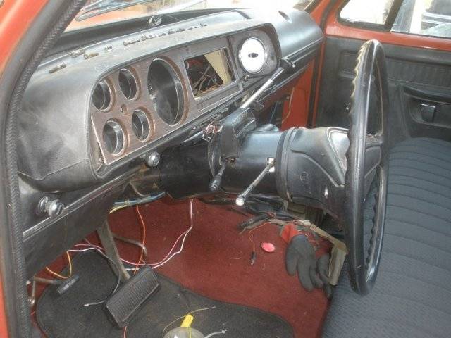

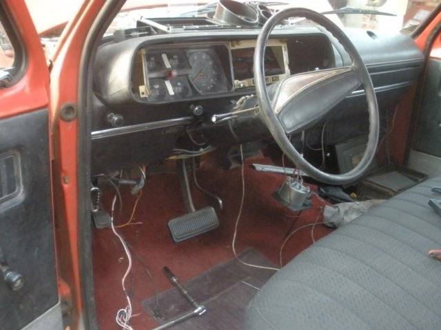

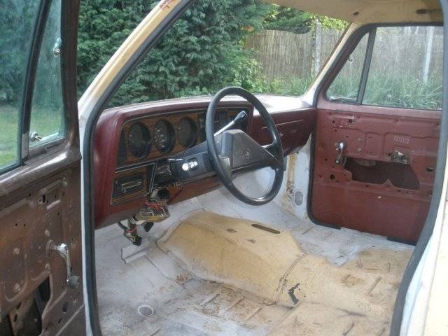

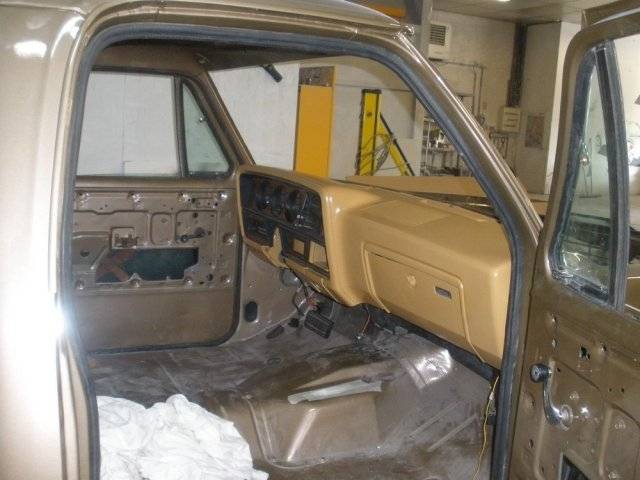

Yes i did that on mine( 79 cab)and it make a nice upgrade with modern stuff like fuel injection power window, door lock.

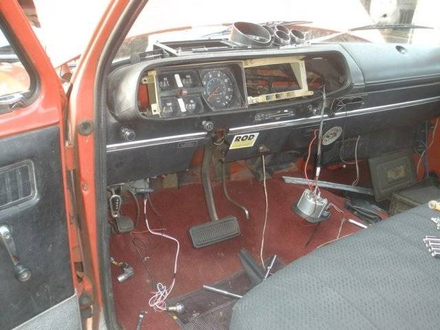

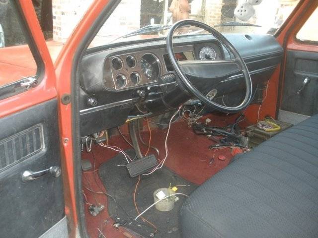

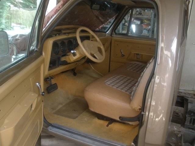

So dash was swapped as well as :steering columnn heater box wiper harness an engine and fuel tank. With a few mods on the cowl for the heater box,and the steering column bracket your dash will fit without problems and look factory. Bonus with the 89 harness your steering column has a light/ wiper/cruise control stalk which is comfortable on long trip.The steering box on 72/89 is outside the frame and easy swappable. modern stuff on old truck.

Yes Bear you are right but have experienced a lot of trouble and gremlins with the early wiring... Just found that using the 89wiring harness was such an improvement Its like having a new harness no more insulation cracked or rotted melted wires and better connectors and bulkead.

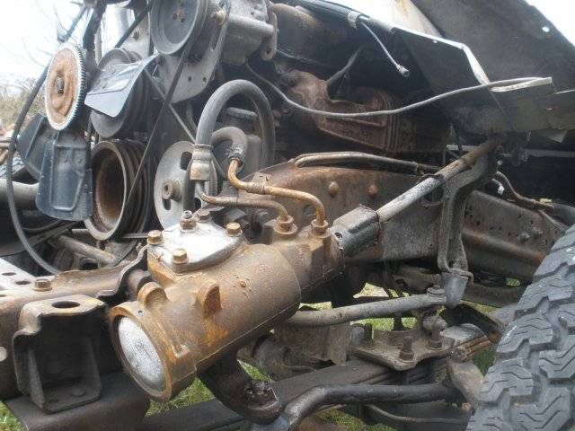

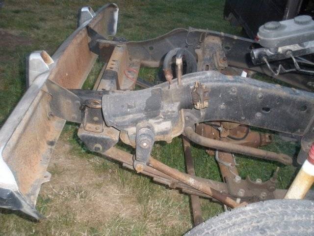

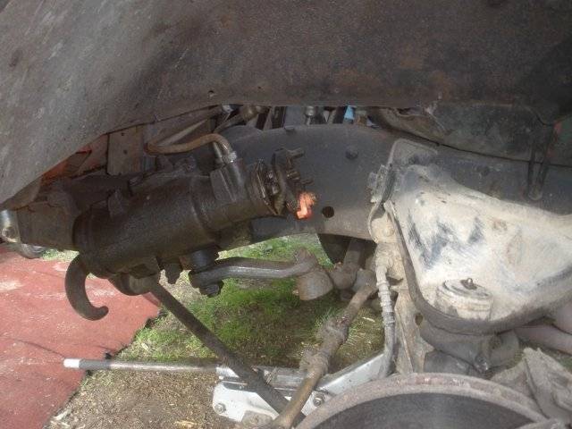

There is 2 different model one with vertical pitman arm for the earlier dodge 72/78 and the second model is the same as the 2wheel drive. The steering arm is longer on the 4wheel drive model To me its the best one
if you run big tyre they wont rub against the suspension. Got this system on my w350 crew cab.
1st photo is from a75 w300
2nd is from a 81 ramcharger.

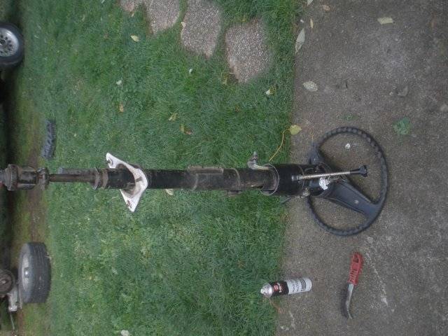

Done a tilt steering swap using everthing from an 88 4x2 and it works Did another swap on my 76 D200 despite the steering column bracket under the dash which is different. had to deal with the intemediate steering shaft which is shorter. I am really happy with such a modification.
