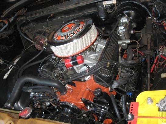

Yah , The booster that should be in yours right now will be right against the valve cover . Your going to either swap to non power brakes or get the small booster . Here's the one I run . If you have any issues finding anything or have any question feel free to ask . IMG_3870.jpg

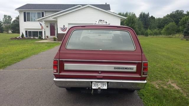

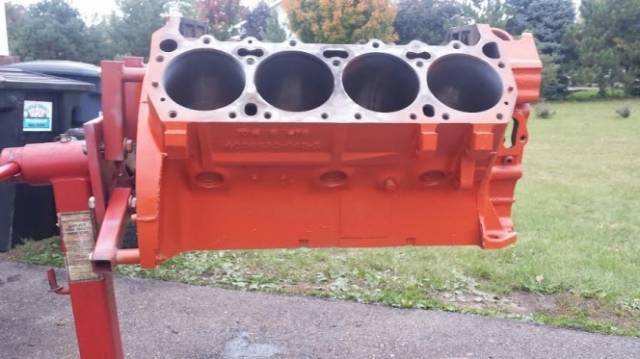

Mine, too. I have a 318 with 73K on it in it now. I dressed it up - put an an aluminum intake and Moroso fabricated aluminum valve covers. It runs and drives just fine. I really want the speed. I bought a 440 last year and tore it down. I got the truck oil pan, the mounts, the big block 727 and truck headers. I have all the engine parts to go back together except the cam, and I am looking at Thumpr cams as we speak. The Dart is still scary fast. I've put on 21,000 miles since the 408 and 200R4 went in. It's almost time to refresh it. I want the Ramcharger running on the 440 before I do that.
I bought it from a guy in White Bear Lake. It was owned by his father in law before he died and was rarely driven. He said he was worried about driving it from it's home in North Branch to White Bear. I told the guy I live in North Branch. He says, oh, he lived just north of the outlet center. I tell him I live just north of the outlet center. It turns out the old guy lived less than a mile from me and I never saw the truck in the 18 years I've lived here. It's not as clean a body as it looks, but it's still in really good shape. If you have the screw in type dipstick tube, I would be ecstatic.
