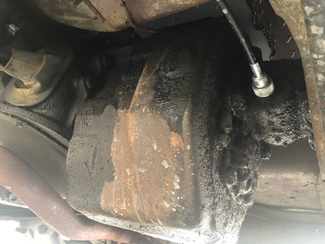

Here's a photo of the trans. My neighbor borrowed the truck to pick up a load of sand this morning so it's riding a little low in the back to get to the back side of the rear end. I'll inspect that later.

The first thing I notice is the lack of a gear shifter sticking through your tunnel. Mine is flatish around the area of the stick, but then rounds out as it goes towards the seat.
-Guess you missed the part about the manual trans going bye-bye. During the last phase of rebuild some how the truck grew from a D150 to a D350 with a commercial frame. At that time it lost the 79 - 360 and long tail shaft 727 and gained a 89 - 360 with a short tail shaft 727. The truck is in its fourth configuration. The trans tunnel stays flat all the way to the seat.

That NP435 is a HD 1:1 final drive trans, with, as you have found out, an extremely low non-synchronized first gear. That is a grain-truck trans, suitable for hauling heavy loads over soft dirt fields.
However, the other gears are not that bad and, the 1/1 final is the same as any other manual trans you might install.
So, while it is not a performance trans, it is not contributing to your buzzzzzzzzzzzzzzz. That would be the grain-truck rear gear ratio,lol.
The A727 automatic will run about 5 to 8, possibly 10% more rpm with no other changes.
The A518 is a natural for you, with it's .69 overdrive ratio, bringing your rpm down by 31% or guessing 800 to 900 rpm. This is IMO the best solution, allowing you to keep whatever ratio is back there, so not in any way affecting your ability to haul stuff .
But it won't be the cheapest.
But your empty fuel mileage will be better.
The early model A518s were hydraulically and automatically controlled overdrives. But you did have the option of locking it out with an extra position on the gearshift selector. I guess you would need the matching column to use that feature.
