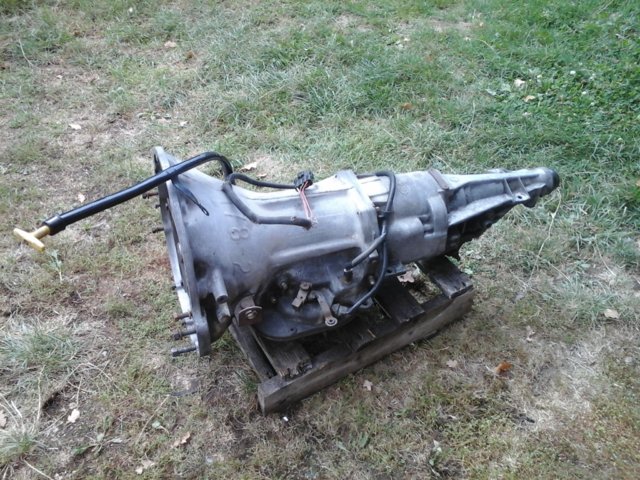

Hey Yall, Just got a 1990 w-150. I believe it's a late 89 since thats what the door reads. In the cab on the dash It has an OD on/off button. What makes me think early 500 trans. I'm just not sure. Any Help would be appreciated.

by the way sporty it's a 518 now I have to figure out If It's a RE or RH.
I have one here myself that I need to figure that out on. Have just not taken the time.

If not wrong the old 518 has a single wire to the valve body the controls od. The transmission I have has that singe wire.
I have no clue I wish someone would chime in to give us some clarity on this. This Trans Is a whole new thing for me. It being such an early model and everything.

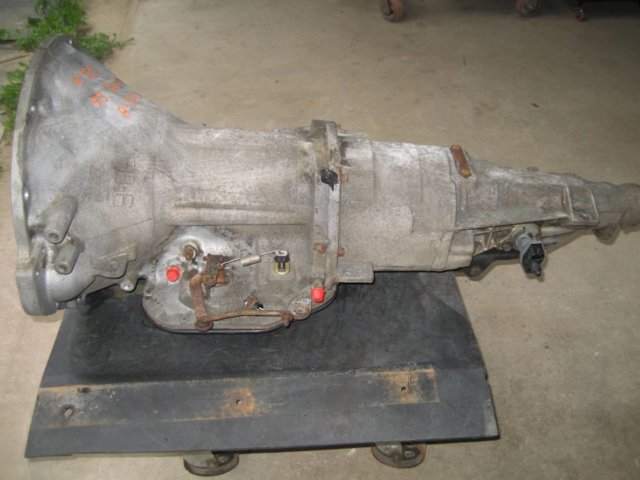

Right your transmission is a rh by the year. should be A500/42rh with lock up and overdrive or early 518/46rh. check the pan must be a deeper one
From the link you shared before from I gathered It looks like A518 not the 500 Sporty. I also had a break in the weather this morning It Is a TBI system. It has a two cable system. I would say one for the pedal and the other for the TV?
