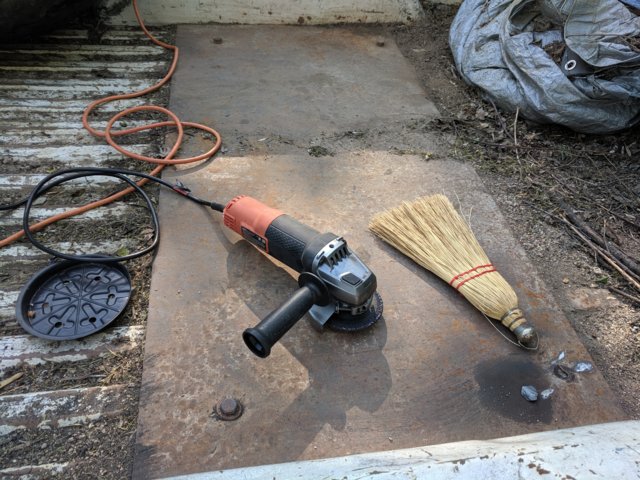

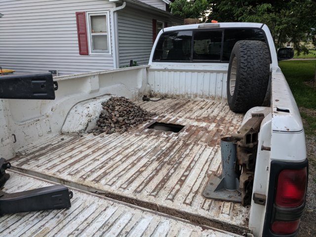

Then I came home and after playing with the camper, I worked on installing the fifth wheel hitch. I was going to drill through the big, heavy plate that was installed for a goose neck trailer. I was going to keep it, but I never used it, so off it came. I forgot I got a grinder, so happy day! I got that bad boy out, and minutes later I had a bare box again.

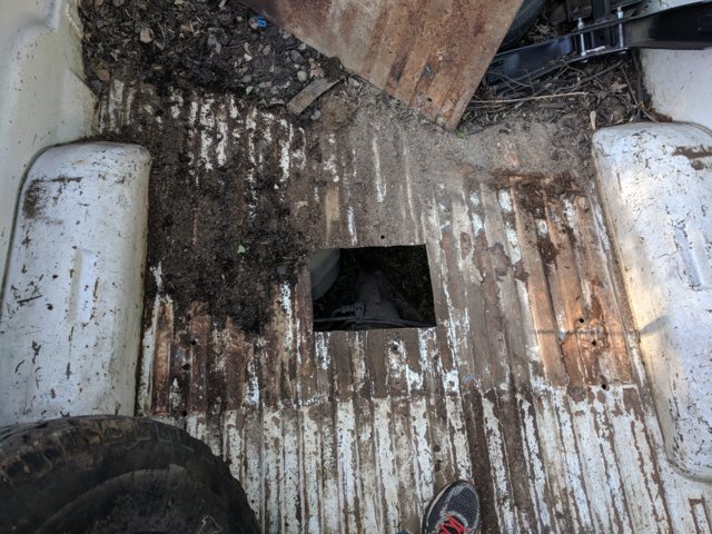

All kinds of crap under the plate.

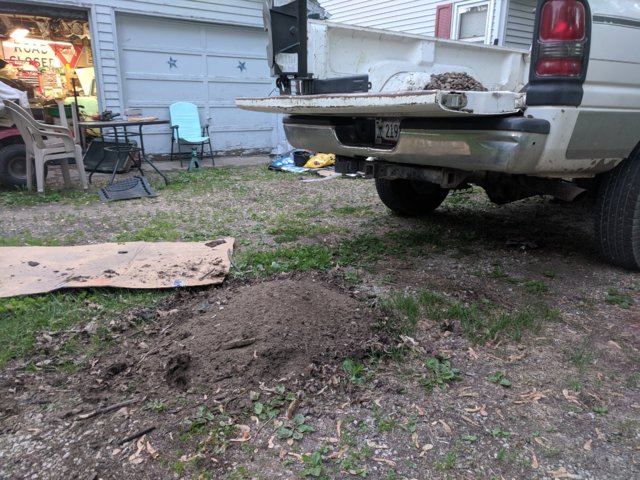

All cleared out. Rock went out front where the dog relocated some of it.
I raised the driveway a little after spreading this out. :joyful:

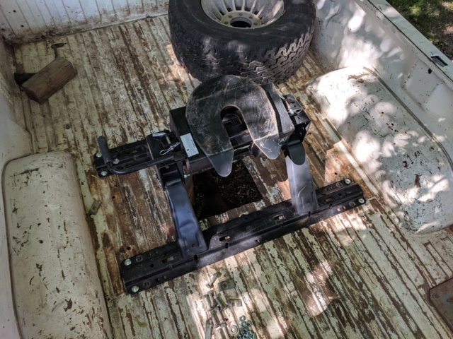

Will have to check out the brackets that were used for the plate, I think I can reuse the front brackets as they are, I might have to move the rear brackets back a few inches. I'll find out tomorrow.
Didn't have to move anything, and after getting some more bolts, nuts and washers, I have a fifth wheel hitch installed in the truck.
Need to tighten up some bolts in the morning, they're snug enough to make the trip to work and back. Then park it in front of the trailer and double check the trailer wiring is good. Then take it for a test drive and get a feel for how it tows. Might need to get some mirror extensions, or see if later years in my body style had the flip out ones.
Did you have to crawl under the truck to put nuts and bolts in place with that big hole in the floor? Not sure yet if I would want to pull a trailer with the hitch fastened to the bed floor only. That has never made since to me but everybody does it and few seen to have a problem with it.

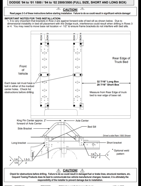

There are brackets that bolt to the frame under the bed, and you bolt the rails right above the sills, so you use the flange to bolt through. Half of the bolts have the brackets.
Here's the instructions to better explain.
