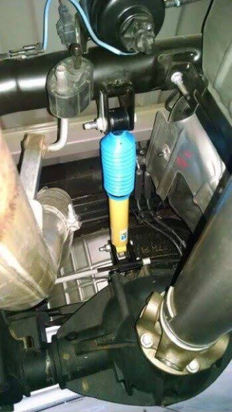

I have a 2017 Ram 2500 and have the 5th shock mounted on top of the differential to the frame and cannot locate a replacement due to Bilstein not having it in stock. I attempted to cross check with monroe but no luck and O'Reilly's was no help, Rancho's website was not much help, Rockauto also left me hanging. How do I locate a shock based on dimensions collapsed height and extended height? Everytime I attempt to search it shows links on how to measure. Any help would be greatly appreciated!
Bilstein Part Number 24-274395
Collapsed: 14.69"
Extended: 20.33"
Diameter: 2"
Eye Internal Diameter: 14.4MM
What was on the truck from the factory not mine just a stock photo
