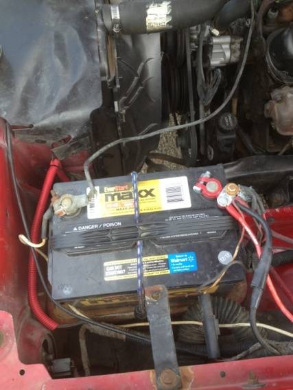

Went to Tractor Supply and bought some one gauge battery cables and changed them out. Gotta go back and get a 12" cable, ( I forgot that) but these things are great!
