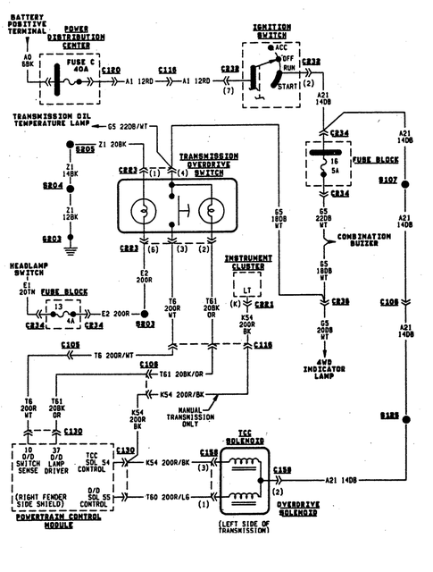

Can a simple single pole toggle switch be installed in place of the original OD switch? And I'm thinking there are more than 3 wires going to the original so I'm not sure how to wire in a toggle switch if possible. Been a long since replacing the 1st one and it seems they are no longer available.

95 is the last year for it to be on the dash iirc....and my problem is that the switch is bad and I can't turn the OD on. It happened the same way about 15 years ago. It's not so bad since I have 30" tall tires on the back but would still like to be able to turn it on when I get on the freeway. 2000 rpm at 40 isn't bad but the rpm @ 65 isn't all that great.

Here it is
enId=14dfcb44-819c-4155-a079-247bc2396293&project=OemContent&file=Wiring\Display\WRCR95\DAKO016c.png
The way I see it, it looks like the switch opens/closes pin 3 to pin 4. Pin 4 is power from the fuse, pin 3 is the O/D sense at the PCM. I would pull the switch out and test pin 3 and 4 to see what has power with O/D engaged and what happens when it's disengaged. I think you can put a toggle switch on pin 3 and 4 like you suggested to turn the O/D off

Finally got around to messing with the OD switch today....and man, a year went by pretty fast! Anyways, pulled it out was was looking it over when the thought hit me to test drive it with the switch totally out of the circuit and dang, the OD works without it! Boy, that was easy :D
Would be nice to go ahead and hook up a toggle switch or just get another factory switch to be able to shut off the OD for the long grades....especially since it's got 31" tires on it....
