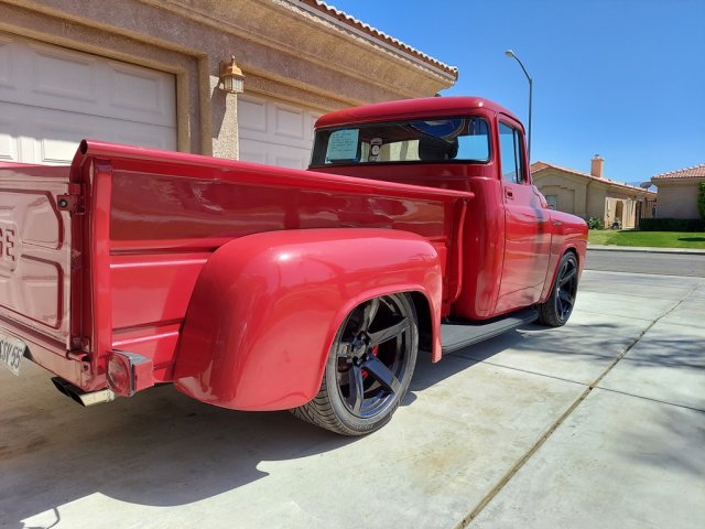

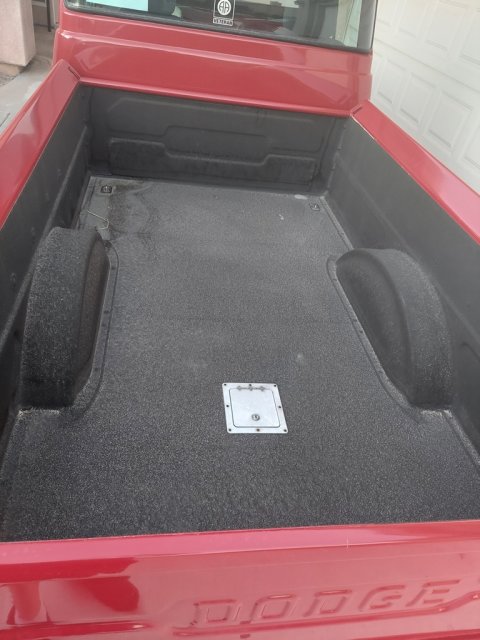

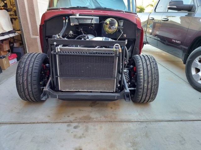

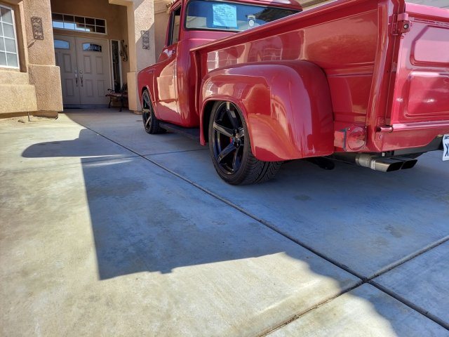

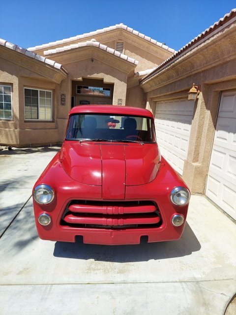

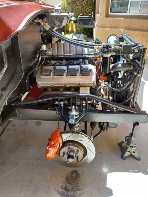

Hey Guys,
Lurked for a while and finally joined (or maybe rejoined, may have been years). I have a 1955 Dodge pickup that is a "pro touring" type build and the wife drives a 2020 Ram.
Have been a Mopar guy for 45 years and love the vehicles. We live out in Palm Desert California. Joined to enjoy other peoples rides and to share any knowledge I have that might help others.
Thanks,
John

Welcome aboard. Wow, that's a beauty! Nice work. Thanks for sharing & best of luck with your toys! 👍 🍻

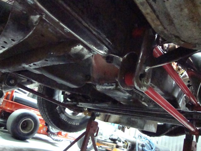

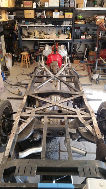

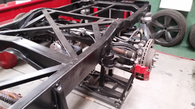

Nice! Is that a Charger rear end?
Hi, yes the rear if from a 2010 SRT challenger basically same as the Charger. It was a nice swap as the rear 2010 cradle mounts were wider than the truck frame so I only had to make outboard mounts. I modified the lower control arms so I could use coil overs and had to make some cutouts for the swaybar and upper links.

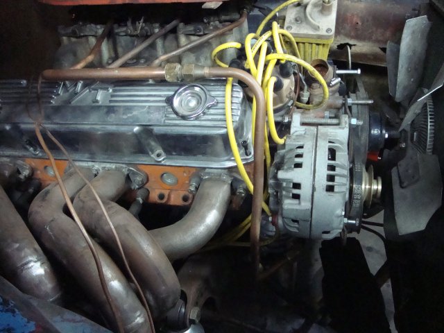

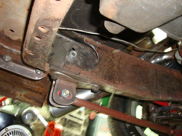

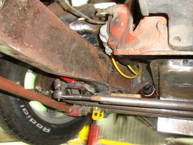

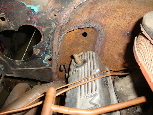

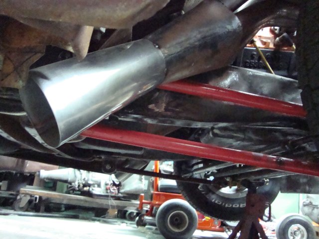

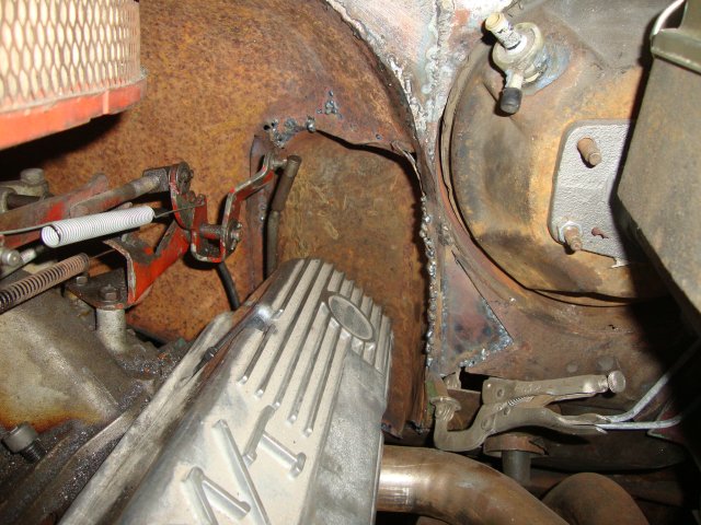

looks great my 60 d100 sweptside has been modified but not near to your extent , but mine is just a bunch of cast off parts that where replaced .

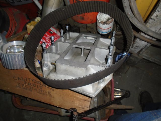

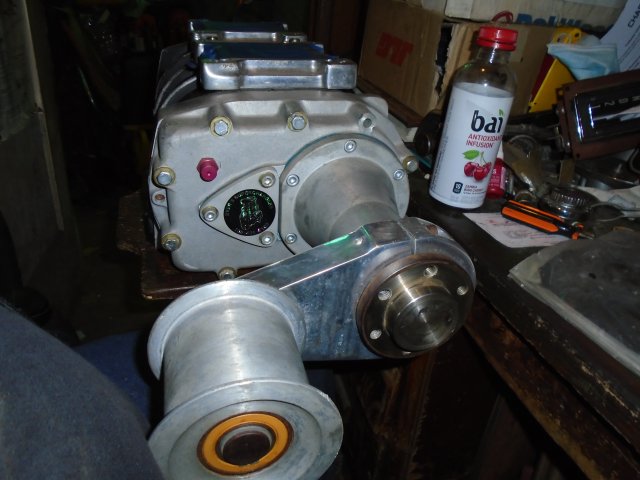

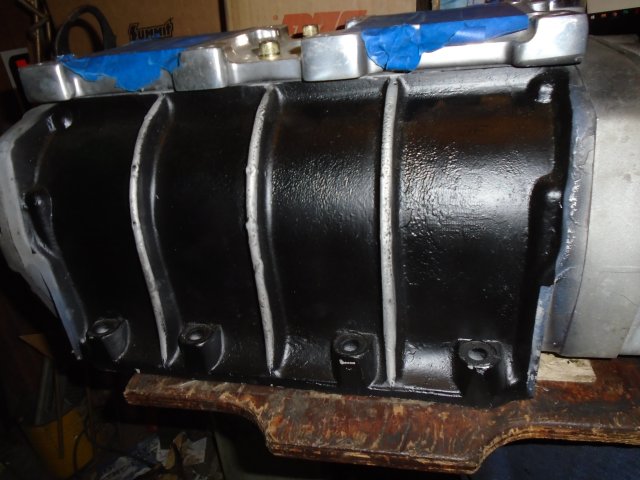

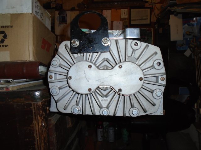

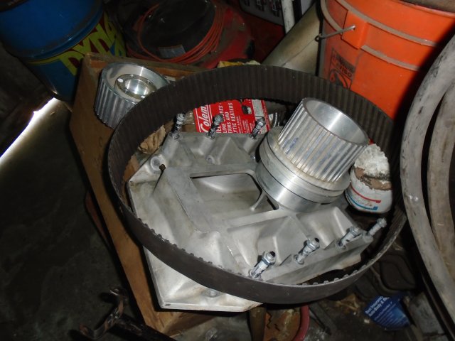

my latest part getting ready for install , again a cast off part , lol . i love living down stream . setted it off had it rebuilt and changed out the fasteners .
