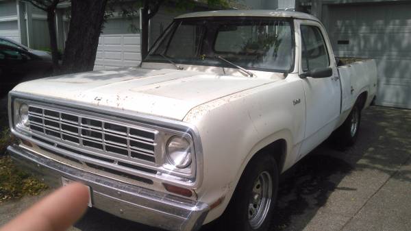

Spotted this 74 on Craigslist for $1k. Rusty cab, bed is pretty banged up, but smog exempt and kinda ran. Rode my bike 80 miles up to get her, did a little tinkering on the engine side wireharness, then drove her on home. It was quite the adventure. The inside rear view mirror was loose, the motorcycle was blocking my view out he rear, no pass side mirror, some tiny garbage piece stuck to drivers side that was completely useless. Cut out for a second here and there, horrific at less than 1/2 throttle, and making the most terrible noises.

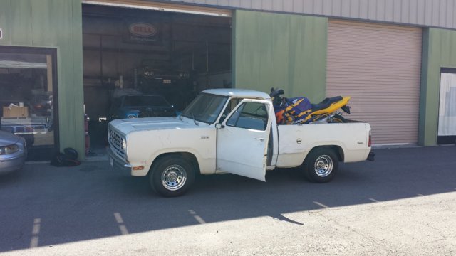

Day I picked her up, bike loaded and ready for the trek home:

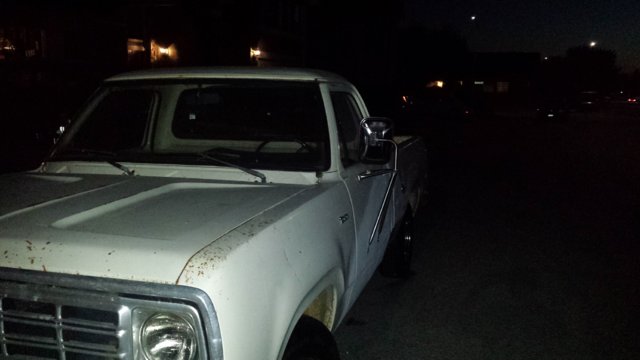

New mirros mounted. Found them new on Amazon:

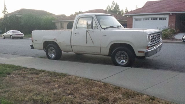

Added a class III receiver, off to towing duty:

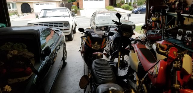

Her driveway mate, a hopped up 73 Plymouth wagon

As pictured from the ad:
