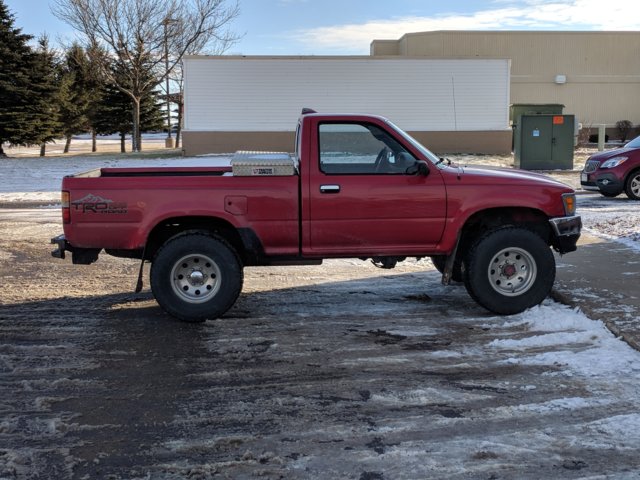

This guy has 300,000 on this one, he swapped engines to keep the pristine body going.
