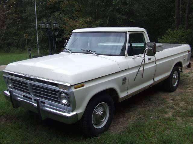

    Never really named a vehicle before, but I named this one. Meet Gladys. Gladys was Mama's first name. She didn't like it so she went by her middle name, Nan. I like Gladys, so as a memorial of sorts to Mama, here's Gladys.
    I bought Gladys nearbout a year ago now. Kitty and I were in a terrible wreck in February, 2014 and totaled my 2004 Ranger. After looking for a few months with no luck, I found Gladys locally one night on CL.
    We drive down to look at her and this is what I came home with. A 1975 F250 Camper Special. After doing some research, I began to realize that Gladys is special indeed. More on that in a minute. This is Gladys very shortly after I bought her.

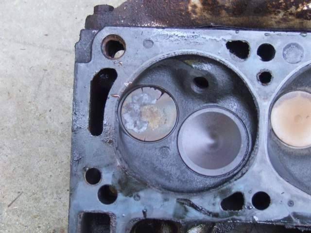

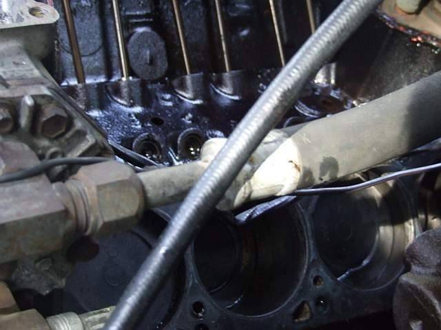

    I have done a lot of work to Gladys since I bought her. The first thing I did was diagnose the dead skip she had. I knew she was skipping when I bought her, but the price was right so I bought her assuming the worse case scenario. I was pretty close to right. She had a burned exhaust valve in #5 cylinder. So, I removed driver's side head and sure enough, #5 exhaust valve was toast.

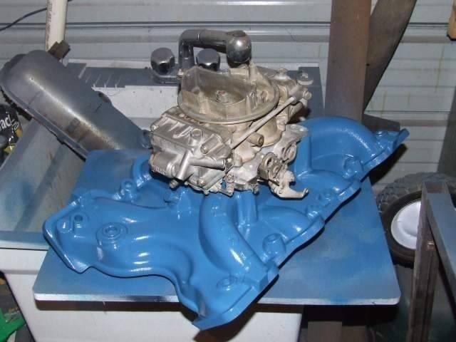

    I took the heads to the machine shop I use. Reeve's RPM Performance in Warner Robins, Georgia. It's 62 miles from my doorstep, but they do great work. Steve, the owner called me a few days later and said that he could rebuild the heads, but for about 150 dollars less, he could order in some remanufactured heads. So that's what I did. About a week later, I had the new heads and Gladys was running great. Gas mileage however, was not so hot. With her Motorcraft two barrel, she wasn't as efficient as she could be, so I hawked Ebay and found this open box return on the cheap. A Weiand Action Plus for the 351M and 400.

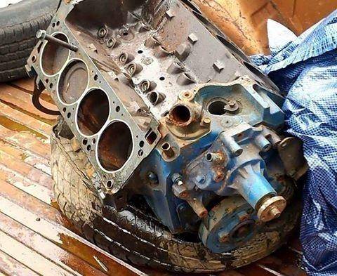

    Of course as an old hot rodder, I cannot leave well enough alone. Always have to have more. lol So the search for a 400 was on. I knew I was climbing a big hill as not many are left. Most have been scrapped a long time ago. That's how the M block is. Either you love them or hate them. I have always been a fan. The 400 Ford was the first 400 small block engine. It was out before the Chevy 400. A lot of people confuse them with a big block because they share the bellhousing bolt pattern with the 460 but they are small blocks. They share all the same internal components as the 351M except crankshaft and pistons. Even the blocks are the same. I got lucky and scored this core. It ended up a LOT better than it looked in these pictures. I want to thank my buddy PanGasket too, because without his help I would not have it.

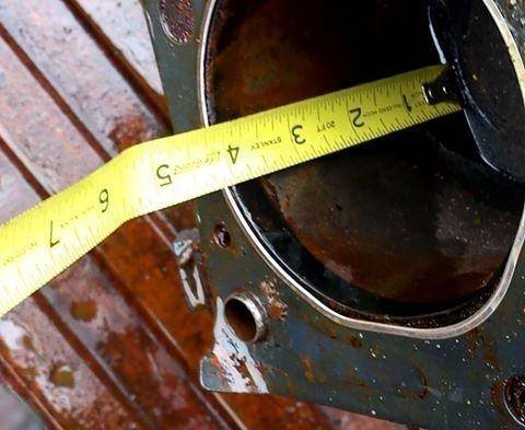

    Distinguishing a 351M or 400 from a 351 Cleveland is easy. The Cleveland is a low deck and the 351M and 400 are tall deck engines. However, since the 351M and 400 used the same casting numbers and exterior markings, there are only two ways to tell the difference between those. Either remove the oil pan and get the crankshaft casting number, or get a head off and measure the piston travel at BDC. Like this. Bingo! We have a 400. 4" bore and 4" stroke. Do the math though and you get 402. I guess Ford thought a 400 would market better.

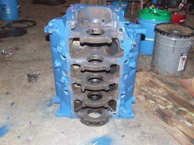

    Once I got it home I began disassembly. I was pretty happy because all the pistons were looking very useable. Until the last one. It had a broken ring land. Dammit all. So, I started hawkin Ebay some more. lol I got lucky again. I found a set of NOS Badger pistons for 25 bucks Shipped. Good grief. Here is the block after a good clean up and top coat.

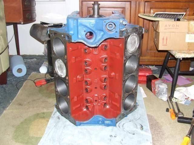

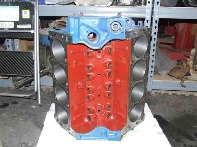

    I was really surprised that the block cleaned up good enough to use at a standard bore, but it did. I like the idea of painting the intake valley to aid oil drain back. I don't like how much red glyptal costs. So through the years I have come up with my own version. It's cheap and it does not come off.

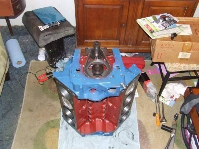

    When I got ready to assemble the short block, Kitty told me to bring it in and do it in the livin room floor. She wanted to spend some time with me and it was cold out. Will yalls women let yall do this?

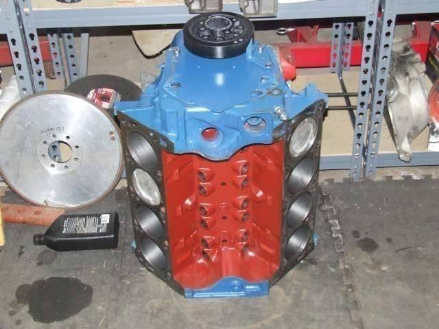

    Here is the finished short block. My heads are still in the shop getting done. No remans this time, as they are the early 351C two barrel castings. Much better for flow on the street. I also scored an NOS Crane Fireball 302 grind that I have since found out was a Canadian only grind. Go figure.
