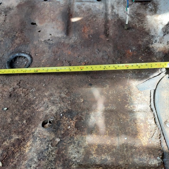

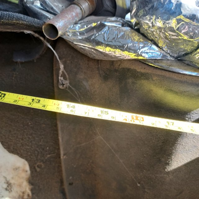

Not sure I agree that the add on fiberglass A833 shifter hump would conform to smaller automatic 2wd floor hump. But here are a couple pics with a tape. The front to back dim was with the tapes end against the vertical surface where the gas pedal pivot mounts. These dims would only apply if you are using the unique truck/van shifter mount and not a passenger car style shifter mount.
