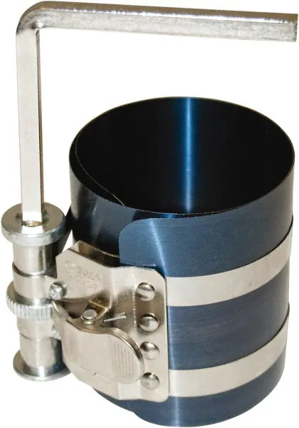

Sucks about the broken ring, but I feel your pain. I have never broke a ring until I did a set in a 13 Equinox 2.4 for my kid. 3 cylinders in and on the last it didn't feel right so I pulled it out to find a broken ring:( I have always used a ring compressor like this one

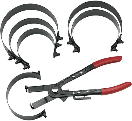

Since I broke that ring I bought one similar to this set

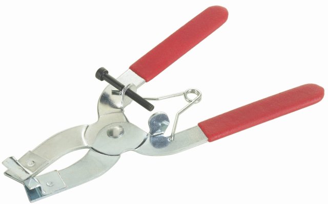

Been there, done that. These help but the ones with the adjustable stop are the only way to go. OTC4389
They make fancy (expensive) ones for the machine shops but these work great.
Yup I have the ones with no stop. It's kind of funny because I'm super careful usually about how much I open the ring. I don't know It's just been a real PIA with this build don't know why haven't changed up anything In my process.

I used to do the same but, someone introduced me to the pliers and haven't looked back since. Happy Thanksgiving yall.
