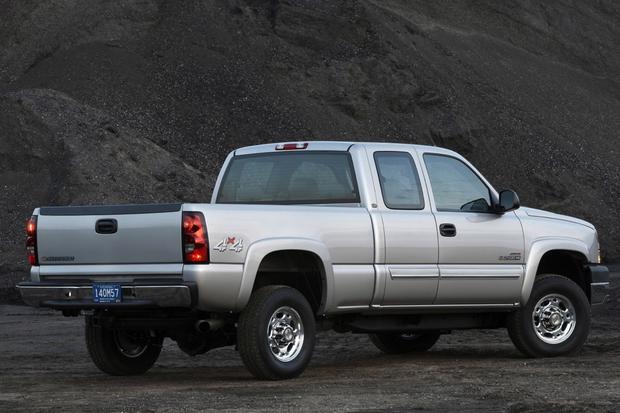

PS: I've noticed, in a very short time, that y'all really like pictures, so I'm posting a stock, internet pic of an identical truck. I'm new here, gotta keep everyone happy 'till I've been here a while.
