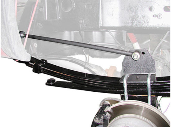

its more like this pic shown on this site.
think of it as the same thing,but they used a shock absorber instead of a solid rod and the mounting plate was much better designed than this one is.
Dodge Truck Traction Bars 1969-1993 by Tuff Country #30695 | SuspensionConnection.com
id really like to find the original style setup,and then copy it or if they are buyable get a set.
