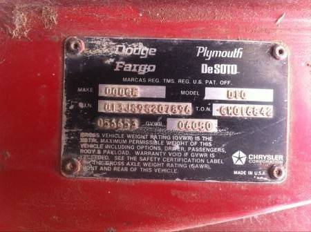

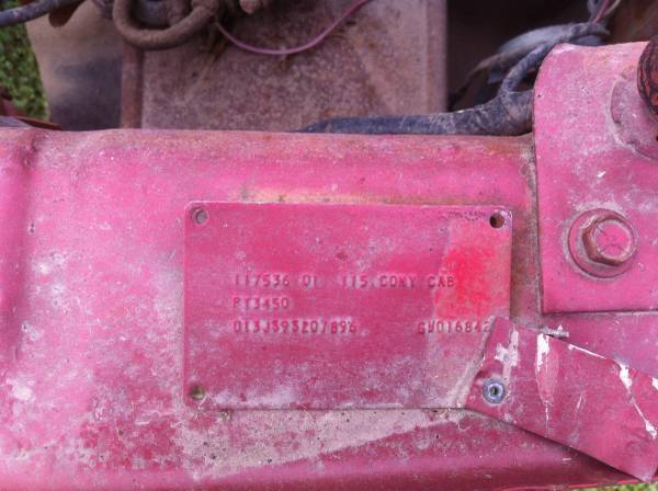

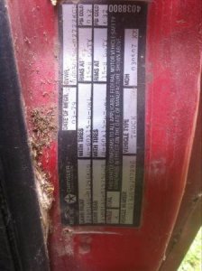

Looking for some info on where to find the Vin for my little Red. I purchased the Truck recently and i am currently in the process of disassemby to start the restoration. Normally the vin is located on the Drivers side dash however i removed the dash and could not find any vin info. I do have a tag on the Drivers side door and the Radiator Core support has the fender tags however i can't seem to find the vin stamped anywhere. I have attached a picture of the Tag on the core support and the door frame which is all i can find.
Can anyone offer any info on where i should be looking for numbers to verify it is actually a Little red.

That's your Vin tag . The 79 should be on the door jam and the 78 is on the door .But I have seen some early 79's on the door ( like my 79 Warlock ) . The location is one of the reason's I think people should be real careful because there is a lot of clones out there . The fifth digit of your VIN should be an S . If you need any help on were the numbers are elsewhere on the truck , like places on the frame just ask or you can even just give me a shout if you like .
Thanks Bear. I found some info on another site which indicated where on the frame the stamped number was. I found the Matching vin on the frame just behind the passenger side front leaf spring perch. Everything matches so looks like i have a real deal LIL Red. Do you know if there is a sequence number for little red's? I believe for 1979 there were 5188 produced so is there any way to tell where in the production line a certain truck was produced. Thanks again.
