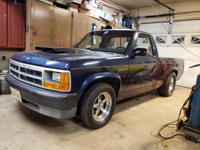

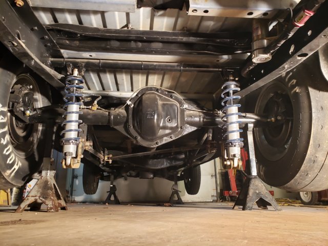

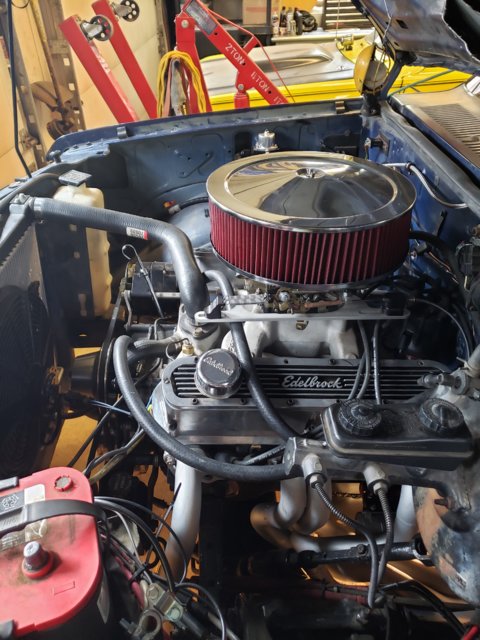

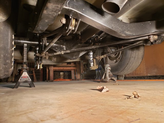

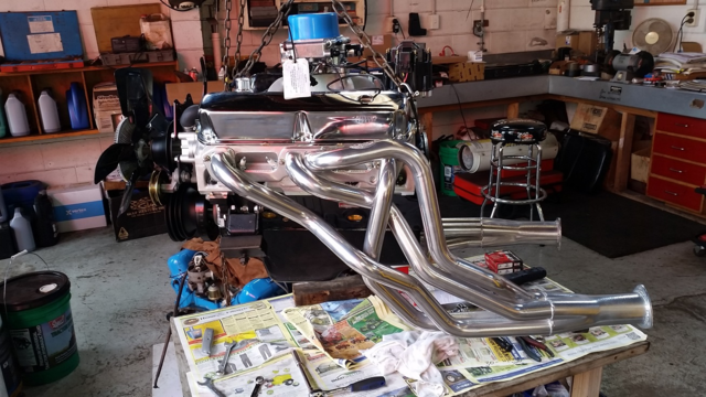

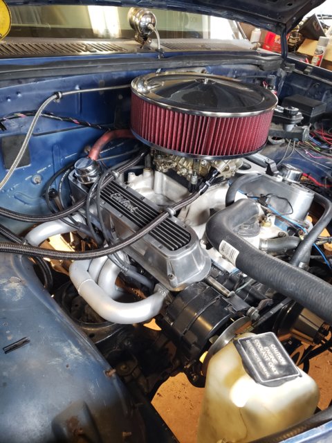

I just spent the last year swapping out a 91 4cyl 5sp to a la 360 with 904 and ladder bar.It was definitely a lot of work doing what I did.So the engine mounts I used some of the 4cylinder and made my own by welding them to the frame.The oil pan I just ordered one for a stock 91 v8 and welded a deep sump on it with a milodon pick up(look at hughes site they have milodon pan with all the measurements for the Dakota).Headers I made my own from abody hooker 5204 that I had leftover and a universal 1 3/4" kit from jegs.Rear got a strange s60 on black Friday with 10% off and free shipping.Used a ladder bar kit from applied racing.Funny I also got this truck for free minus a case of beer.I built this for my son to bracket race and just made it's first pass two weeks ago.It went 11.29 at 116mph at mir.Guess I need to figure out how to slow it down so he can run sportsman and high school classes.
@Mhead
Thanks for the pics, Ima thinking ladder bars too, but a lil less tire,lol. Was that crossmember part of the kit?
Your welcome. Yes the kit came with everything including the crossmember. The rear is stock a body width,wheels are 8" with 4" back spacing and tires are 28×11.5.They fit inside the wheel well without cutting anything. The front I just ordered new 1990 Dakota rotors so I have five lug pattern.
good to know!
What sort of 60fts are you getting with that combo?
