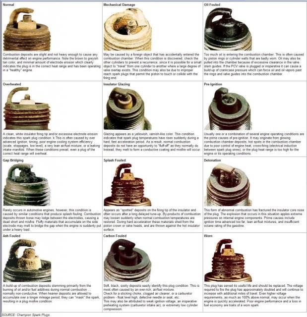

    Inspecting Spark Plugs
    It's always best to inspect your spark plugs in the case of a misfire or even when doing a routine change. Your spark plugs can give you a lot of information about the way your motor is running.
