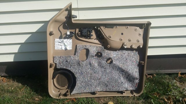

Hi All,

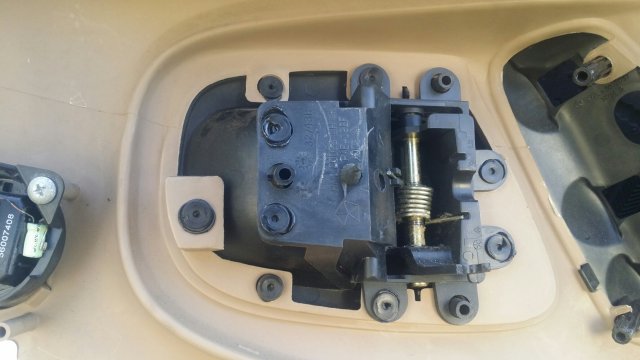

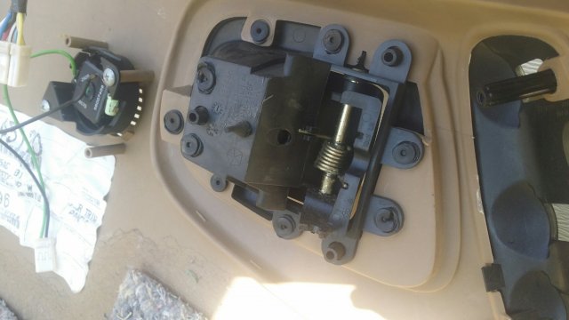

It has been awhile since I posted here but I have another question for you experts. I bought another Durango recently and I took the door panel or I believe card off to fix the window, and now the inside door hinge broke so now I need a new one. My question is how the hell do I get it off? Here are some pictures, any help would be appreciated.......

What you have pic's of looks like the inside door handle, I googled it and found 1 video where it had already been removed once and had screws in place of the melted plastic. You will have to grind the plastic off to remove the handle then hold the new handle on with screws installed where the plastic was melted over.

Pop rivets will split the plasic towers. Screws will likely come with the handle.
Just did this on a hhr. Kit supplied a forstner bits and screws. Cut the melted plastic part and install handle with screws. Hokey at best. Not much for a 3/8 long screw to bite into.

So very sorry I did not give an update on this. I did cut the plastic off as mentioned and put screws in place of the plastic. I unfortunately do not have photos as I did not think to take any. Thank you fine folks for the help on this little project since it was my first time doing it, it was much appreciated
