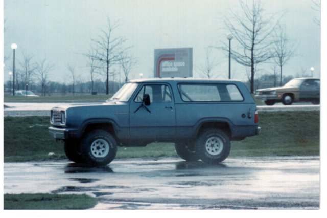

My '77 SM say's 85-125 foot pounds. Never broke a lug stud on the AW Ramchargers or Trailduster that I had.
an old mid 80's picture...........
