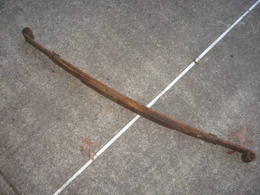

If it helps . This is what the stock springs look like .
