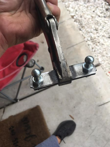

Working on replacing the floor pans in my 75 D300 manual transmission.
When I got the truck one of the ball studs was missing (very annoying, but totally workable). When I removed the rest of the assembly (the second ball stud and the bolt that holds everything together) the second ball stud snapped. I figured, no big deal, I'm sure there's a reproduction of that just like there is the floor pans.
There 'may' be a reproduction pedal floor mount assembly, but I can't find it.
So, does anybody know where to find this reproduction part or, what are y'all doing if you need to replace the entire gas pedal assembly?

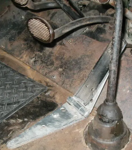

Maybe time for some fab work. A piece of rod and a few ball bearings maybe. If you are replacing the floor pan that would be a clue a welder of some sort is available.
A little ingenuity with a door hinge
I considered something like that. But my goal is to have a nice interior, ratty exterior with a nice interior. So I'm looking for a cleaner way to do it.

Looks good. Now to fasten it to the floor.
That's exactly what I was looking for! Rebuild the plate on the top of the floor to match the plate that fits under the pan, and it should be all good.
Thank you
