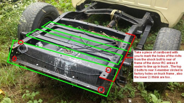

dodgefred Well-Known Member Joined Oct 16, 2015 Messages 226 Reaction score 401 Location chamblet May 14, 2019 #5 use a ramcharger tank its just an easy job .just need to get the donor truck brackets.mine is from an efi truck .
