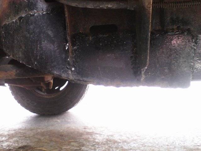

I have a 98 Chevy 2500 and the frame is rusted out by the drivers front body mount, I see a lot of this in the rust belt. Any one else see this? I think I will repair it by plating it with some steel on the sides and bottom.
Here is the repair, I used some steel I had, made some cardboard templates, used some C-clamps to bend into position and weld away.
